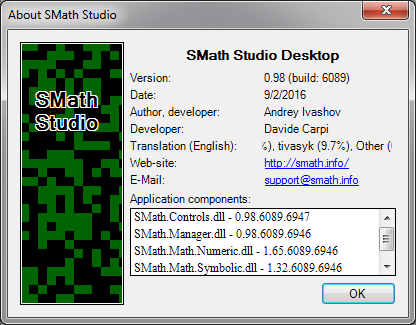

SQLLite Plug-in can be installed using Extensions Manager only starting from SMath Studio 0.98.6089. Previous versions of the program cannot install this plug-in correctly. I would highly recommend you to upgrade.
BTW: If you see error message with "GUID: 00000000-0000-..." then you are using old version of the plug-in. Please delete it and install latest one using Extensions Manager with SMath Studio 0.98.6089 or higher.

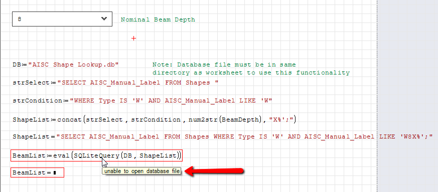

Thanks, Davide. That does eliminate the zero GUID error on subsequent opens of those worksheets, although the "Unable to open database file" error is still present. Recalculating, saving and reopening, changing variable names, nothing I've tried seems to help.
Jason
Your example works perfectly for me (even without eval(...)). Please attach a worksheet and the database, so we can try to understand where might be the issue.

Taking in account error message returned by SQLLite plug-in it looks like latest version of the plug-in installed correctly, but for some reason it cannot find a file (or similar issue, like the file cannot be opened for read operation).
Please try to specify absolute path to the *.db file and ensure this file not used by any other application. If it will help, then it seems there is a bug in the plug-in (may be not, but it is just a first impression).

Yep! Absolute path worked. Thank you, Andrey! I had assumed that since the original example worksheet didn't give a full path name to the database file, that it was a relative path based on the database file being in the same folder as the worksheet. I had originally extracted Chris's example zip file to my desktop, then copied the db file over to a Dropbox folder I keep all my SMath worksheets in. I thought I'd been working with the db file in that projects folder, but it was apparently still referencing back to the one in the extracted zip file on my desktop. Changing the name back to match that made my worksheet start working again. Then I added the full folder path to the DB:="..." assignment in that and another test worksheet, and it could correctly open each database file. I'm not sure how the link to the original extract folder was persisting, but specifying the full path seems to eliminate that issue.
#33 Опубликовано: 07.09.2016 12:27:16
Mike Kaganski
Mike Kaganski
Please note that if you double-click the .sm, then SMath opens with the directory where the .sm located as current path; so all subsequent relative paths will be searched under this directory. But if you start SMath from, say, desktop shortcut, and then open the .sm from it, then current directory will be that was specified in the shortcut. The same will happen if you opened SMath by double-clicking one .sm, (and its path is now current directory), and then from that SMath open another .sm from another directory: the second directory won't be current one.
So, using relative paths in SMath is error-prone. If SMath for each .sm would make its own current path as one where the file is, regardless of opening method, then it would be good. For now, I wouldn't advise anyone to use relative paths.
