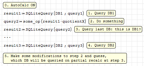

  1. Could you consider using a identifier (number or string) as a "handle" to open connection? For example,
    SQLiteOpen("connection1","path1"="open"
    SQLiteOpen("connection2","path2"="open"
    m:=SQLiteQuery("connection1","query"
    query2:=<some processing involving m>
    SQLiteQuery("connection2",query2)
    <some other processing with both connections 1 and 2>
    Or the SQLiteOpen could return the numeric handle on succcess, or an error with a description on failure.

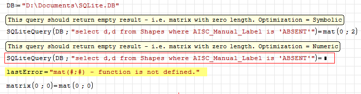

    If no fields are returned by the database engine, the function will return the string "No Results"
    Imo, it would be better to return matrix(0,0) in this case. And please return a matrix in all cases, even on single return, thus eliminating the need for conditionals in the calculations. If one knows that only single return will come, this may be handled by simply using el(result,1).
A very good suggestion, implemented straight away.

Partial recalculation seems to work as far as I can tell.
You are quite right, closing the database connection in the end makes a full recalculation necessary.
Closing the database file is not necessary if the database is only read. At the latest when SMath Studio is closed the database connections are terminated. I am however not sure whether "SQLiteClose" can be safely ignored if write operations to the database have been performed.
Opening a file will not impose additional overhead if the file is already open. The plugin will now recognise this and simply report the handle.
You can always collect any handle opened and close all them internally when SMath closes (Dispose() method)

SQLiteQuery(0,"select * from Shapes"
gives me an error "The cast is illegal" (translated from Russian - specific wording may differ).
SQLiteQuery(0,"select * from Units"
works OK
I suppose it may have something to do with decimal separator? Or a problem when returning an empty value?

Testing 1.0.6083.4
Previously reported errors are gone, thanks!
But I see a problem with returning empty result sets:
Something's wrong with the approach I suggested (using matrix(0,n)). Maybe Andrey could suggest something here?
С уважением, Михаил Каганский
Christopher Bietz 31.08.2016 08:56:00
#13 Опубликовано: 29.08.2016 14:32:52
I think the approach "matrix as result" is good, maybe there is something to improve in the SS logic. If you try to assign matrix(0,n) to a variable, you can show mat(0,n) in a standalone display of the result with numeric evaluation if at definition is stored symbolically, but not if it is stored numerically (that is the same error while you are trying to display the inline result); this affects also rows()/cols()/length() (unable to process the variable when it is stored numerically). I'll talk with Andrey about this.
BTW 'NULL as result is very good idea, +1 for this.

Davide,
I must yet get used to your new status as SMath co-developer. I haven't yet had a chance to congratulate you with that Thank you for all your past and future contributions! And I will remember to address my questions WRT SMath internals to both of you from now on.
WRT empty matrices. There used to be yet another application for them: using as initializers for loops, to assign an empty n-col 0-row matrix to a variable, and then use stack() uniformly in a loop to fill it (of course, if the number of rows is known in advance, that may be done differeently and more efficient). This functionality was definitely available at some point (unfortunately, I cannot find a link to it atm, because I explained this technique in Russian forum, that is unavailable now).
Davide Carpi 30.08.2016 11:26:00
#16 Опубликовано: 30.08.2016 11:35:23
Thanks for the congratulations Mike. I'm very grateful to Andrey for this opportunity
I know about this useful feature, that's why I think this particular form should be enforced

  • Removed single argument SQLiteQuery due to inconsistencies with partial recalculation.
  • Null entries in database return custom unit 'NULL and are now distinguishable from empty strings, simplified code.
  • Fixed and improved the example file
  • Added typetest table to example database and tested every case successfully
Thanks yet again for all the useful feedback I've received.
I completely oversaw this issue, to preserve consistency and repeatability even with partial recalculation I have removed the single argument version of SQLiteQuery
