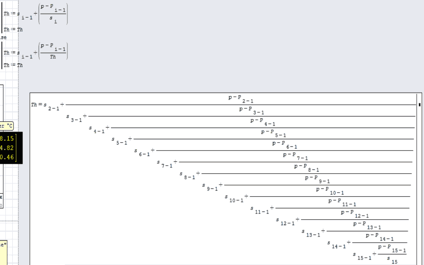

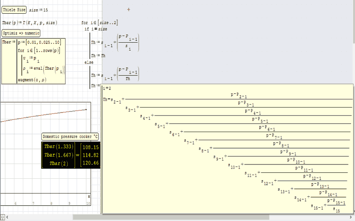

When you put in Smath Studio the pointer over an operation, as in this case
of the Thiele function, you get the following visualization of the result.

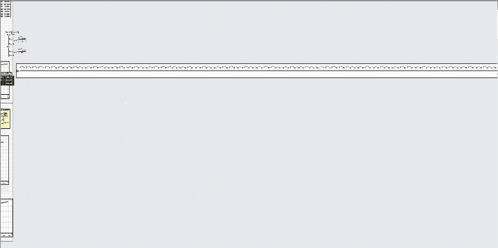

When Smath Studio is requested to present the result, it is shown as follows:
Here the question is: if Smath Studio has 2 forms of presentation,
which I call implicit and explicit. Why not explicitly have also the first (the Implicit),
which in this particular case, I consider, which is a better visualization of the function?
#2 Опубликовано: 02.05.2018 19:49:16
Try using "none" instead of "symbolic" optimization
#3 Опубликовано: 02.05.2018 23:20:01
CBG
CBG
Thanks, Davide.
It works perfect.
