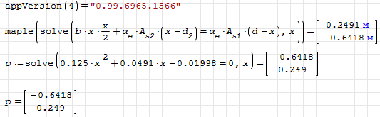

Alternatively you can try maple() function from the Maple Tools extension.

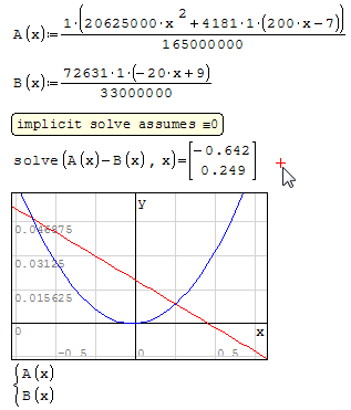

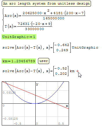

Hello, maybe someone could help
1. recast the functions unitless
2. plot
3. solve implicit in this case.

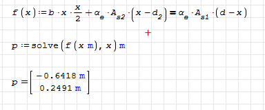

Hi. You need to handle units in the SMath solve function. Here it's a way.

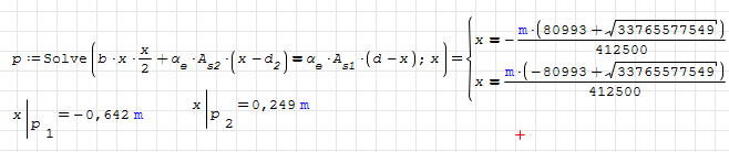

Solve() from the Maxima plugin can handle units directly (symbolic solver)
2019-01-28 14_26_49-SMath Studio - [Gelzbetonines%20konstrukcijos%20ilinkio%20skaiciavimas.sm_].png
