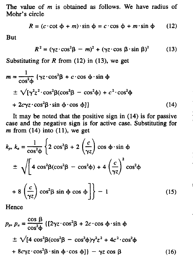

i want to solve below problem
m, ka, pa
i try to solve this problem
but i can't get result.
20230614_lateral earth pressure.sm (100,47 КиБ) скачан 1429 раз(а).
Thanks in advance
#2 Опубликовано: 14.06.2023 22:48:20
Hi. Maybe the attached helps, but's hard to know. At the eqn 16 I count two open [ and only one closed ].
20230614_lateral earth pressure.sm (74,8 КиБ) скачан 1449 раз(а).

My suggested solution is in the attached.
Get more accurate solutions from roots(,,,)

Hi. Another way, plugin-less version. Have the advantage that can recognize the active and passive cases.
