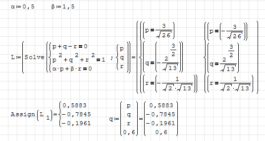

"Sometimes the Maxima function Solve can replace the Mathcad solution block, see attachment.
What is the problem with Maxima plotting? Please give an example of what you try and how it fails."
