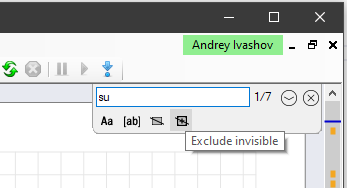

Improved Search panel:

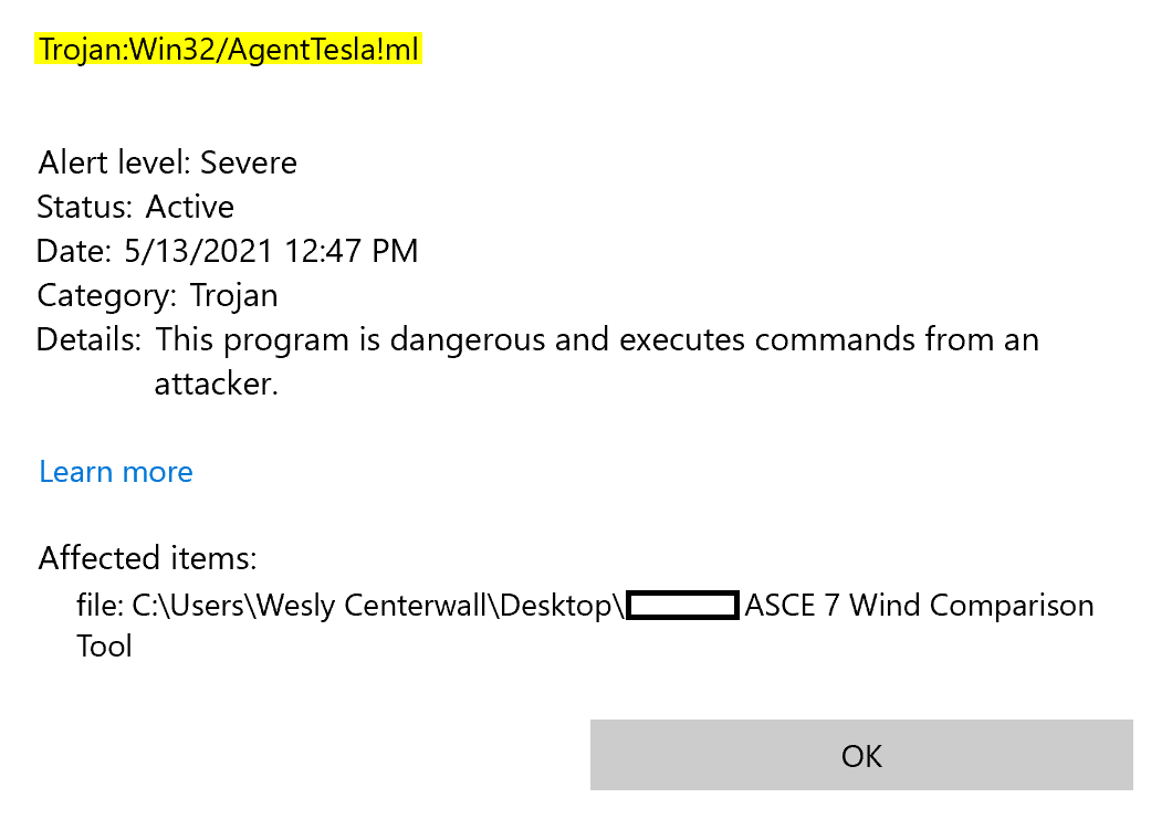

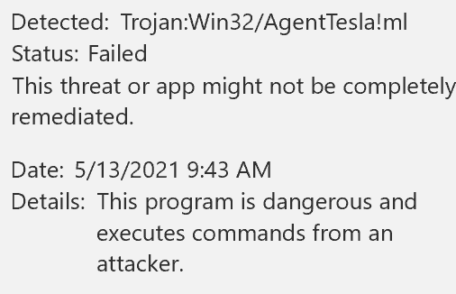

I'm getting a virus issue when I save an exe in the full version.
The file seems to work fine on the computer I created it on, but when I send it to another PC, windows defender blocks it and detects the trojan Win32/AgentTesla!ml.
Not sure how to handle this. I can't distribute exe files like this.
*when I send it in a zipped folder via email.

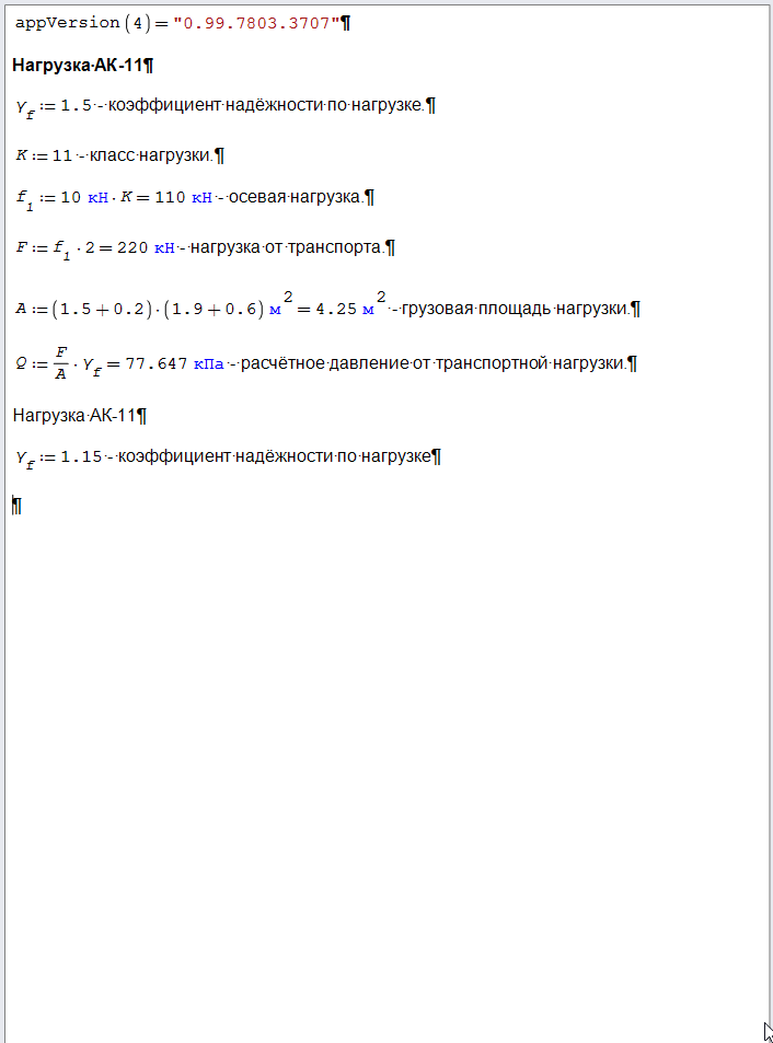

Problems with copy and paste in document mode
#17 Опубликовано: 14.05.2021 10:03:19
I confirm what is indicated by Denis, even in my installation
#18 Опубликовано: 14.05.2021 10:40:27
Группа: Super Administrator
Yeah, it is a known issue - copy/paste of content inside Text Region is not implemented yet (except simple text). I plan to handle it soon.

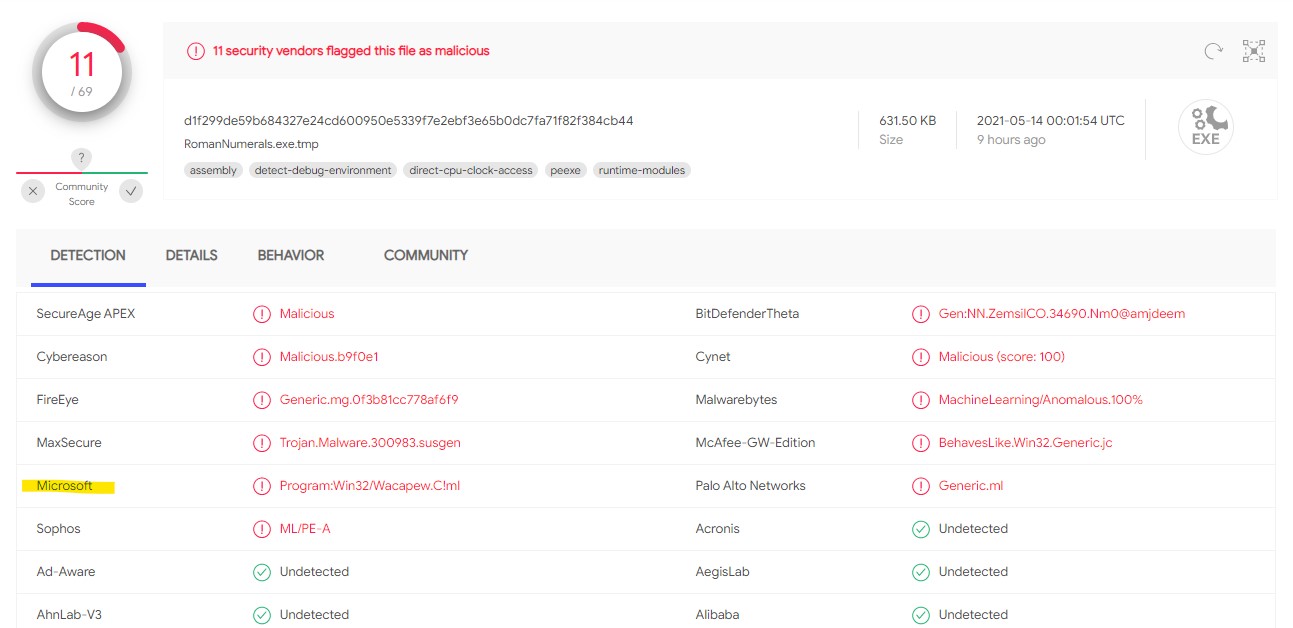

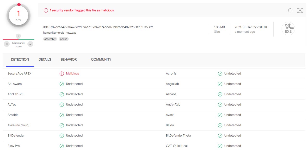

I have some good news regarding false positive detection! After a long night and morning I've found binary pattern which triggers some AVs to mark executables created by Viewer as malicious...

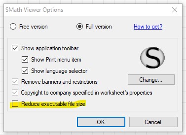

Knowing it I've added possibility to give AVs a fight! Unfortunately I have to disable compression of internal resources to do it, but I do not think it is so bad.
Please try a new SMath Studio version - it has the following checkbox (uncheck -> file size increased -> AVs are happy -> profit):
Here are results of testing the output result in VirusTotal:
Before
https://www.virustotal.com/gui/file/d1f299de59b684327e24cd600950e5339f7e2ebf3e65b0dc7fa71f82f384cb44/detection
After
https://www.virustotal.com/gui/file/d0e5782c2ea4793b426d9d39aed13e87d174dcda8bb2adb4823953893f835389/detection
