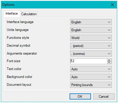

When I change the font size to 12 under Tools -> Options... the change does not get saved.
The dialog box looks like this after I change the font size to 12 and before I click the OK button.
After I click the OK button and open the dialog box again the value changes back to 10.
"Changes will take effect after restart".
In a Smath work sheet, each region supports font size at will, from the Menu.
Very handy to reduce/enlarge some function/results.
#3 Опубликовано: 17.04.2018 11:19:22
In your Smath version the note is missing
"Changes will take effect after Program restart".
#4 Опубликовано: 17.04.2018 18:24:49
A very old issue, I'll take a look if can be easily fixed... the setting however is applied and available since you press ok (talking about recent versions)
