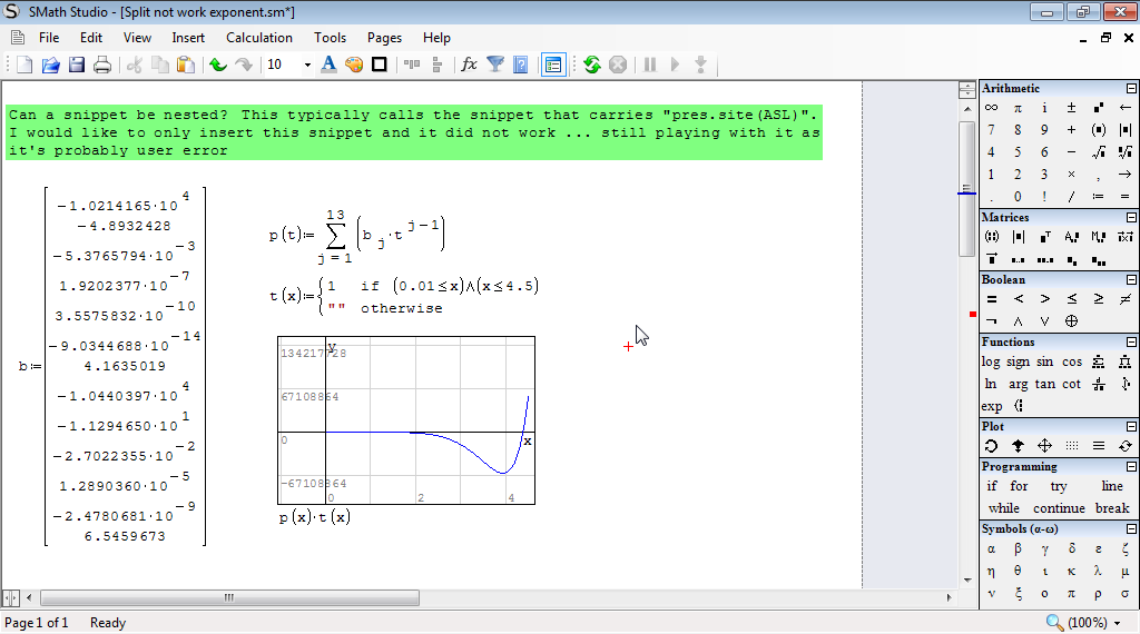

I have a few questions
  1. Can a snippet be nested? I have a function "snippet" that relies on another snippet. This file is an example and I want to reference only this snippet function which will embed the other snippet function
  2. Do Snippets need to be saved as SM? I had an issue with my SMZ files which I default to saving everything out of habit. I have not tried this version
  3. Equation wrap does not work on exponents. I know this feature is a work in progress. I even posted a work around
Split not work exponent.sm (14,33 КиБ) скачан 1742 раз(а).

User error on the Snippet. Because snippets are static, you can embed one Snippet that calls on another Snippet. I thought it was more of a reference like rfile. I like to go back and update documentation/clarifications as time goes by.
Jean,
The sheet I posted is the second half "liquid" equation, per ASHRAE, to calculate the water vapor pressure. It's parabolic and the numbers are within calculation error due to the coefficients being converted from SI to IP. Disclaimer is in the 2017 ASHRAE Handbook. The sample values that I ran, I was within 0.002 psi of most values published in the handbook ... well within engineering tolerances

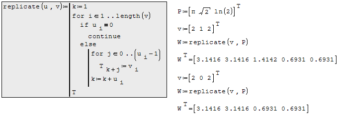

I have problem with new version (6670).
Assigning a variable value with the appropriate unit before the "for" loop causes an error, where the older version (6622) worked correctly.
example.sm (5,62 КиБ) скачан 1801 раз(а). - example
My exaple in old wersion
My example in new version

Hello, Rafal.
This is by design. In the example you are trying to set element of scalar by index. This is an error. In previous versions of SMath Studio program just lost value of the scalar, which was wrong.
You have three options here:
1) Remove σ:=100*MPa line at all (actually it gave nothing to you in previous versions of SMath Studio as well);
1) Add Clear(σ)=... before the for loop;
2) Use another name for σ variable.

A message like "element assignment is only possible for empty or matrix objects" would help. I am not aware of other situations where such an assignment might fail, thus this message could be used by default in failing element assignments.
"element assignment is only possible for empty or matrix objects" ... I like it
"can not calculate" is much more real because there is nothing to calculate.
If some wish list would ask for Mathematica style zillions error messages,
that will not replace reading the Smath Handbook.
"for loop can not index a constant"
"not a scalar assignment" [typical Mathcad style]
As it looks, the matter was to replicate a value.
