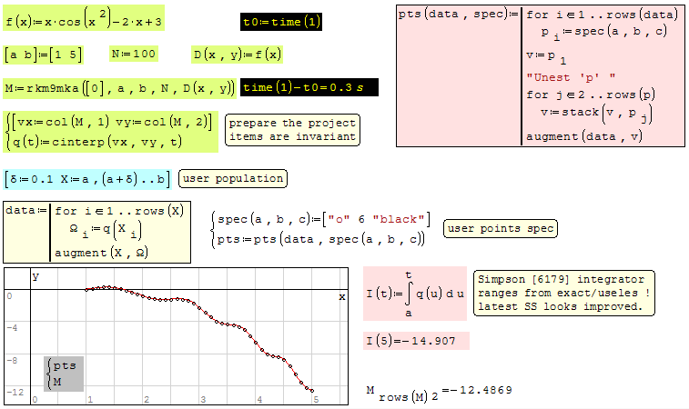

#2 Опубликовано: 29.11.2018 23:48:00
I can't reproduce this in SMath.
1/1 in Smath 6179, proof: the snippet.
Cheers Alvaro

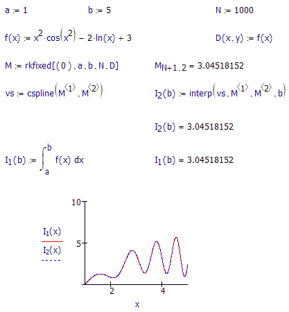

#3 Опубликовано: 29.11.2018 23:59:54
You may not be able to implement the Mathcad bloc Given/ODEsolve.
ODEsolve is based on linterp. That is the first point.
The other point is that in Mathcad "linterp(x)" is a scalar function.
In Smath: ainterp, cinterp, linterp are simply interpolation fncts
They are not scalar functions. How does it reflects in ODEsolve ?
In Smath, ln(x), exp(x), ... are scalar from source code.
I tried to make cinterp scalar like in Mathcad, not to avail.
Please, persist on such a beautiful idea.

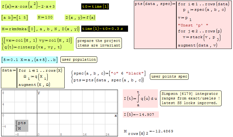

#4 Опубликовано: 30.11.2018 01:16:48
This document was essentially designed to plot scalar the derivative on canvas,
as well as get a discrete export. Also included: the scalar quadratic.
Spline Deriv Infinitesimal.sm (70,87 КиБ) скачан 1347 раз(а).

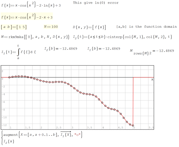

#5 Опубликовано: 30.11.2018 02:31:22
Hi Jean. Actually not, just the solver, without the given.
I found how to call the odesolver, with D(x,y)=[f(x)].
This method is much more faster than the direct integration.
But remains the ln(0) error, which seems to be a bug in the odesolvers, because zero isn't in the domain range.
Integrate with ode solver.sm (10,17 КиБ) скачан 1274 раз(а).

#6 Опубликовано: 30.11.2018 03:35:52
The zero point is used to determine the dimension of the vector D(t,x) at runtime (D(0, x0)). The size of the system must be determined for the further operation of the numerical algorithm. It seems that it would be correct to substitute the beginning of the interval. I will try to change this. Also, if possible, I will support the one-dimensional case.

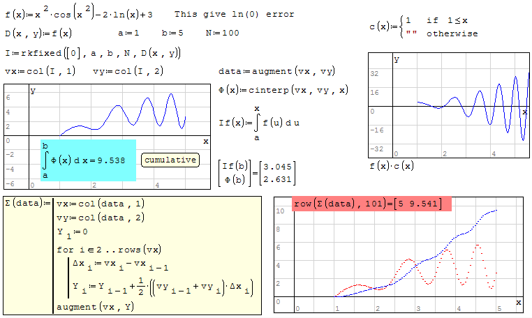

#9 Опубликовано: 30.11.2018 12:34:54
#10 Опубликовано: 30.11.2018 15:36:38
... refreshed version wrt explore all solvers.
ODE 0_Model General.sm (38,44 КиБ) скачан 1265 раз(а).
