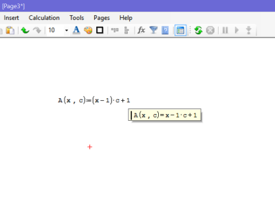

When the cursor is over an equation, it shows the long version of it. However, the tooltip equation (with the yellow background) misses often brackets, which makes the equation wrong. See attached:tooltipproblem.png

#3 Опубликовано: 22.08.2016 12:38:44
Группа: Super Administrator
Thank you! Will fix it asap.
#4 Опубликовано: 22.08.2016 12:47:19
Fixed. Will not be an issue anymore in the next SMath Studio release.

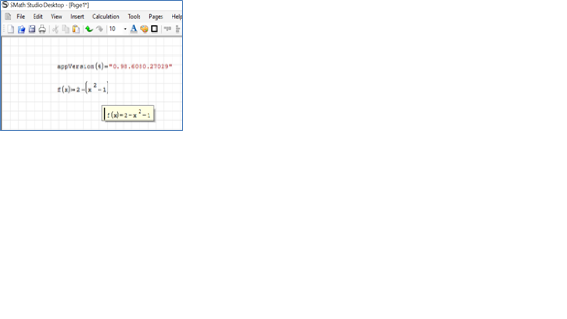

Tool tips problem.
Tooltip.pngTool tips problem

Fixed: http://en.smath.info/forum/yaf_postst7719_SMath-Studio-0-98-6081--25-August-2016.aspx
#7 Опубликовано: 25.08.2016 16:56:20
NDTM Amarasekera
NDTM Amarasekera
Thank you Andrey!
It works fine
