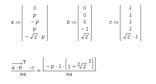

Hi~ I'm studyng building structural analysis.

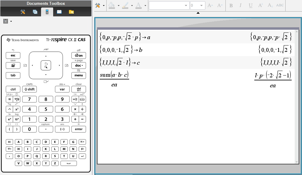

When I calculate the displacement, I have to use list calculation like below using Ti nspire.
I would try this way in smath studio, but failed.
How can I calculate in smath studio?
thank you for your help.
#2 Опубликовано: 07.12.2025 09:23:36
StvMath
StvMath
43 сообщений из 68 понравились и 1 не понравились пользователям.

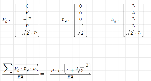

The following uses vectors rather than lists:
You beat me to it by seconds!

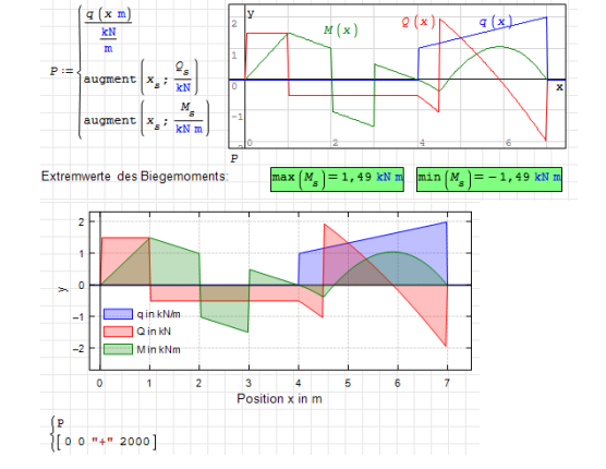

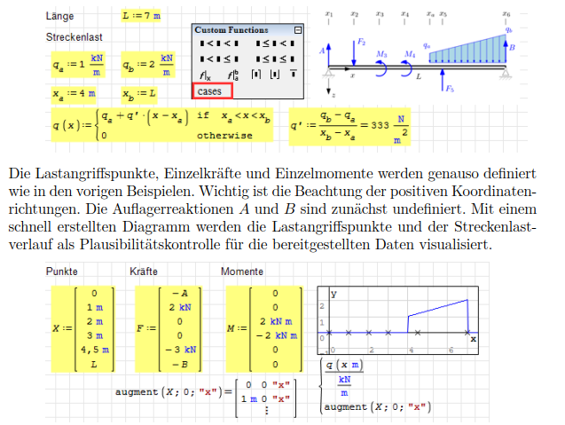

I have just submitted a book on Engineering Mechanics with SMath Studio for publishing. It is to appear early next year. The examples are already available at Github https://github.com/sn-code-inside/Technische-Mechanik-mit-SMath.
See example 5.5.
Отредактировано 07.12.2025 17:19:11
sergio 07.12.2025 16:48:11, Alvaro 08.12.2025 08:52:29, Davide Carpi 08.12.2025 10:42:01, kimkim 07.12.2025 14:32:30
