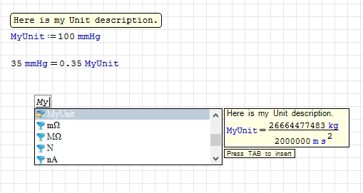

Hi. I agree with Martin. Also, in the standard way to introduce new units in SMath, you can add your own unit description, again, in the standard form.
I don't check if you can add different description for different languages.
