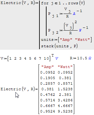

I was wondering whether it is possible to change the unit of a matrix element within a for loop.
Here is a small example:
Example
I would like to change for example the Current and Power unity to mA and mW respectively.
Thanks in advance

#3 Опубликовано: 10.06.2022 18:44:50
Subjectively better looking version for Razonar's example.
Not very practical though, need to re-write for every new units.
I think this should be a feature, using a matrix units for matrix output.
This is how I wrote a pseudo 'matrix looking like' variable.
'\005B\ohm\0020\mA\0020\μV\005D\
Rest is copy paste to place holders.
matrixunits.sm (3,49 КиБ) скачан 1292 раз(а).

#4 Опубликовано: 11.06.2022 04:18:53
Very smart use of multiplicative split of result display!
#5 Опубликовано: 11.06.2022 07:55:17
I don't know if example below is posted before.
You can create multiline named variables too.
Same logic with post I wrote matrixed units.
Copy text below and paste into smath.
This\0020\is\0020\a\000A\multiline\000A\variable:10^3

#6 Опубликовано: 11.06.2022 09:34:30
You can make it algo style for in-situ command line.
