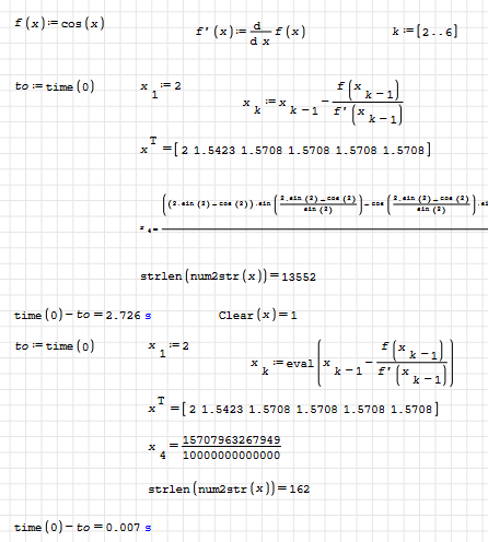

by default SMath evaluate simbolically. In short, this means that if you have (f.e.) X=a+b+c=A, the expression (a+b+c) is stored and then evaluated on request; so if you have Y=d+e=B and you want to calculate X+Y, SMath returns a+b+c+d+e, not A+B. This minimize the error propagation.
When you use eval(), the calculation of a+b+c is performed and the numerical result (A) is stored.
When you have loops or complex calculation, the expression terms might stack in a very long equation. If you have a vector or a matrix, each element might contains a lot of them.
When the complexity arise, since an evaluation requires to retrieve each element from the memory, replace it, and perform the actual calculations, it might be useful to perform an eval() (in some functions the result is forced to be a numerical evalution, so the performance improvement might vary).

Hi. This example can illustrate what Davide says.
using_eval.sm (19,85 КиБ) скачан 1649 раз(а).

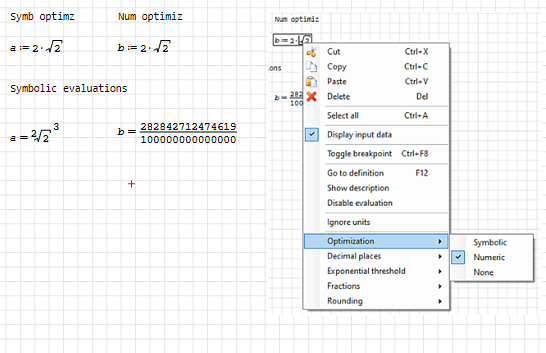

... think that an 'auto-eval' mode would be a useful feature, but maybe this is not possible to integrate into the Smath structure. ...
Hi. There is something like that, the Optimization/Numeric option from the contextual menu. You can also select all expressions with Ctrl-A and choose that option for the entire worksheet.
num-optimiz.sm (71,39 КиБ) скачан 1638 раз(а).
