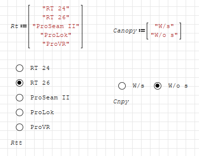

I cannot reproduce on windows too. What SMath Studio and plugin versions are you using?
