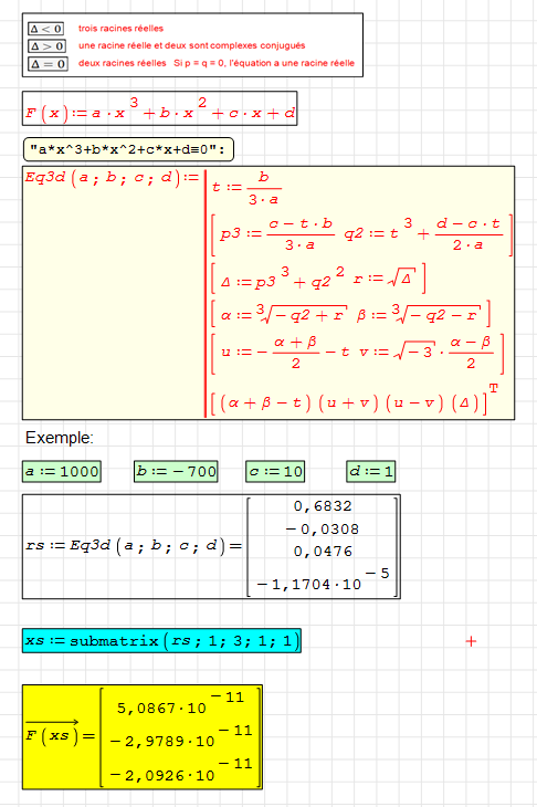

Finally, I want to know if there is a procedure to calculate Eigenvalues and Eigenvectors from a system, and how to calculate roots from a third order polynomial.
Thank you very much for your time.

Hi JJ,
Here is a solution:

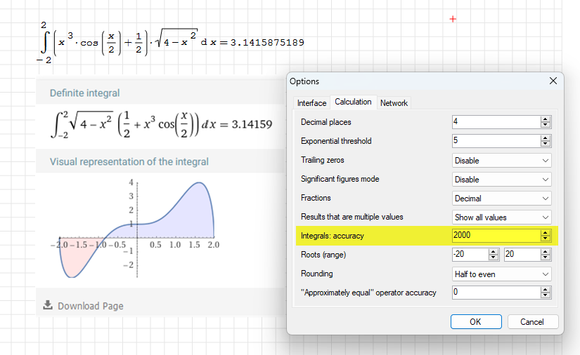

int((x^3*cos(x/2)+1/2)*sqrt(4-x^2),x,-2,2) is calculating incorrect
#6 Опубликовано: 02.04.2024 15:48:37
You have to play with the "Integrals accuracy" global setting (Tools > Options... > Calculation)
