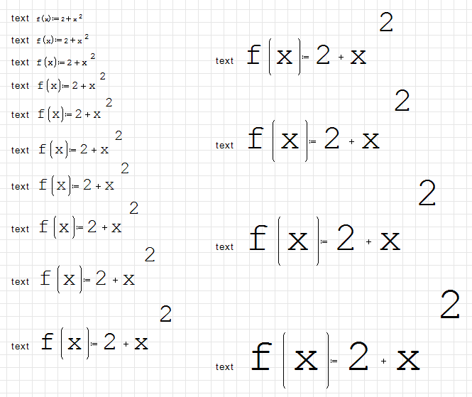

Is there any way to make the writer region line up horizontally with a math region? I can only get it slightly higher or slightly lower, I can't get them to match.
#46 Опубликовано: 19.04.2016 19:44:19
I'm a little bit confused here (horizontally vs higher/lower)... You mean vertically?
The problem is... align to what? Just about math regions, different regions with the same vertical positions may have different baseline just changing the content or the font-size.
A very dirty solution is to place the WriterRegion with the top margin above the one of the MathRegion you want to align and add a first empty line with the height that better fit your needs (not the best approach).
I've planned to customize paragraphs to let the user choose line-height/top margin/bottom-margin of each one, but this feature involves several things, must be planned and deployed carefully.
#52 Опубликовано: 02.05.2016 18:47:08
... you may have noticed in "Courrier" [Smath default font]
capitals have same height than numbers, thus text align horizontally.
#53 Опубликовано: 02.05.2016 20:32:34
What is a "writer region" ???
A region to have rich text in the worksheet
Показать спойлер
Yes I know. Unfortunately .NET doesn't help at all in precise text measuring, and math regions are based on the parameter "middle line" (that is wonderful in math regions, close to magic, but doesn't helps here). As for now, I've solved with the dumb way... I've measured the distances with Paint.NET, tabulated the results, provided the scaling for different DPI settings (this affects only the mutual vertical alignment between the two regions, if requested from the user, or the math alignment inside the region itself, if math regions are used inside the writer region).
Показать спойлер

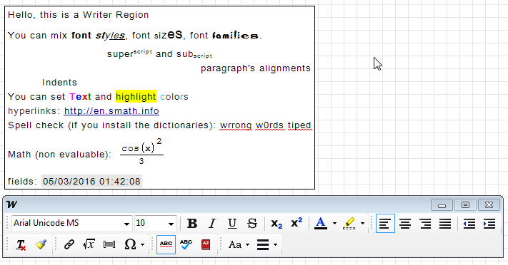

PLUGIN UPDATED SMath Studio 0.98.5935 and latest Nightly Build
  • [LINUX] horizontal arrangement of characters improved;
  • [LINUX] disabled SpellCheck on non-Windows environments to avoid exceptions from NHunspell/Hunspell libraries;
  • [LINUX] patched symbols & colors dropdown menus (buttons with predefined options are not available, however now it is possible to access the dialogs for the generic options);
  • [LINUX] some forms were displayed incorrectly;
tested in previous beta relases:
  • added option to popup toolbar on creation, on focus or just on request;
  • toolbar minimize;
  • Vertical alignment relatively to canvas' math regions;
  • XMCD export (requires latest nightly build);
