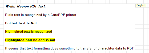

#35 Опубликовано: 13.03.2016 14:42:02
Alexander O. Melnik
Alexander O. Melnik
Davide,
Wanted to bring to your attention the following peculiarity of printing .sm file with a writer region to PDF. Not all text is recognized as text in the resulting PDF file (makes the PDF file non-searchable). There is a patter to the madness, so there is hope that something can be done.
Many thanks for the region! I use it all the time.
WriterRegionPrintToPDF.sm (2,18 КиБ) скачан 1701 раз(а).
WriterRegionPrintToPDF.pdf (20,83 КиБ) скачан 853 раз(а).
#36 Опубликовано: 13.03.2016 15:48:28
Hello Alex
I'm aware of that; there's not transfer of characters or text between plugins and the pdf printer, the worksheet is processed as an image and the OCR of the printer you use it may produce a better or worst result. Part of the problem however is in the plugin itself because the text is not rendered at "full quality" (because issues in GDI+ vs text measurements); this is something very complex to address, recently I've seen a possible solution/improvement that involves the use of unmanaged code from the OS (namely the technique used by this project:HTML renderer), but I don't know if this may break the plug-in compatibility in some OS (and how much work would be needed to replace the part of code involved).
#37 Опубликовано: 13.03.2016 15:56:02
Alexander O. Melnik
Alexander O. Melnik
Hello Alex
From the sounds of it, the benefit would not justify the difficulty of the tweak.
