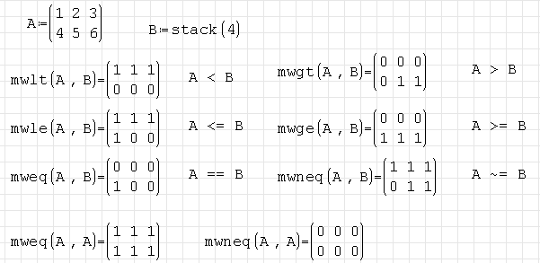

Updated. mwsign(1), mweq(2), mwge(2), mwgt(2), mwle(2), mwlt(2), mwneq(2) added.
Relational operations (Reference, p. 32).

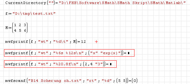

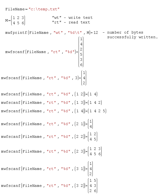

Updated. mwfprintf(4), mwfscanf(3), mwfscanf(4).
Цитата
By the way, the second argument does not need to be a matrix. Scalar will do the job as well
Yes, but it's an undocumented feature. The function takes a matrix as a parameter.
Martin Kraska 21.08.2013 17:46:00, Radovan Omorjan 21.08.2013 05:40:00

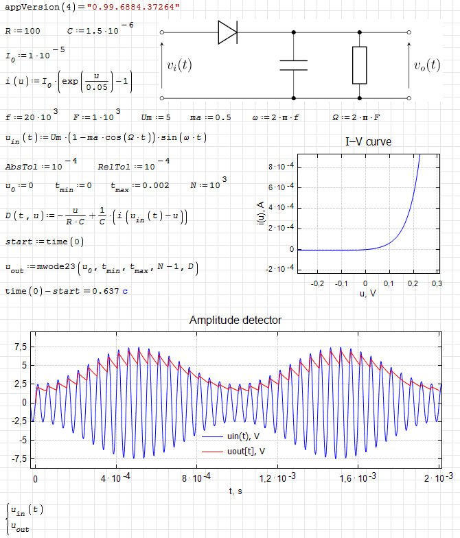

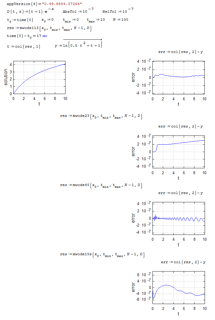

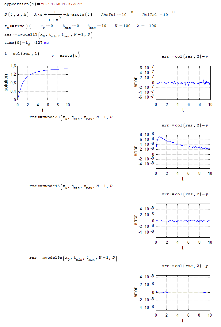

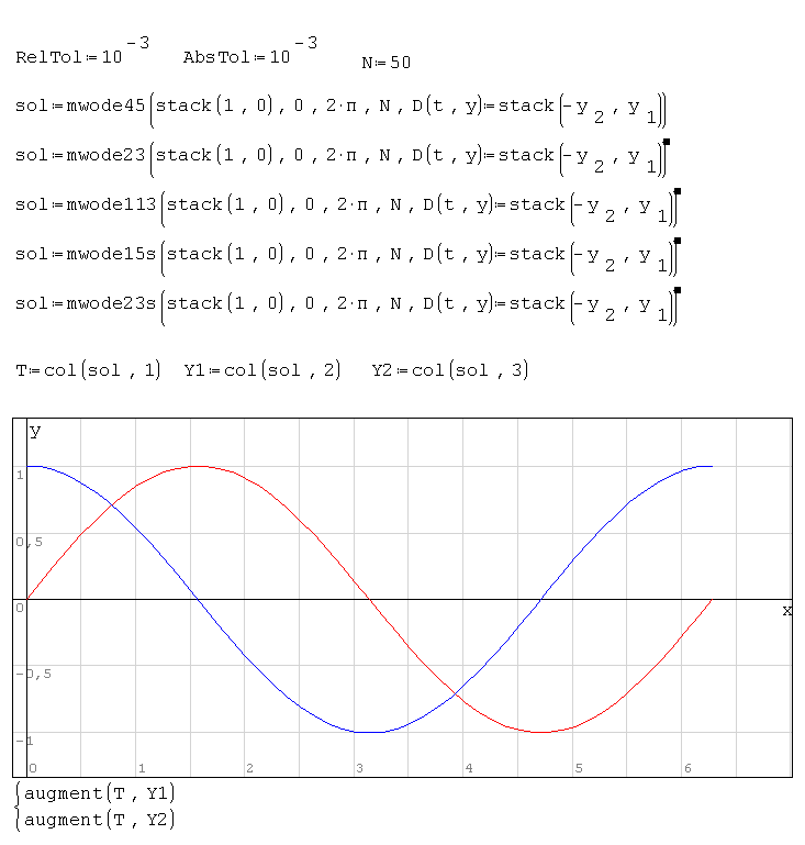

Updated. mwode45(5), mwode23(5), mwode113(5), mwode15s(5), mwode23s(5) added.
mwode45(5) - (init, x1, x2, intvls, D) solve non-stiff differential equations, medium order method.
mwode23(5) - (init, x1, x2, intvls, D) solve non-stiff differential equations, low order method.
mwode113(5) - (init, x1, x2, intvls, D) solve non-stiff differential equations, variable order method.
mwode15s(5) - (init, x1, x2, intvls, D) solve stiff differential equations and DAEs, variable order method.
mwode23s(5) - (init, x1, x2, intvls, D) solve stiff differential equations, low order method.
Matlab C++ Math Library. ODE solvers. Arenstorf orbit.pdf (99,13 КиБ) скачан 1355 раз(а).
Now it is documented, but perhaps not officially supported ;-) Is there any chance to overload the operators? Do they have internal functions that could be overwritten?
Also, thanks for the file ops. Writing of strings is not supported so far?
I fail to read the datafile even if I remove the first line with the column titles. Would be interesting to see what performance we get.
One remark to function naming: This is of course entirely in the souvereignity of the plugin creator. Still I would make some recommendations, driven by
the objective, to make an SMath document as much math-on-paper like as opposed to program code.
- I'd recommend to shift the information on the function's origin from name prefixes like dn_, al_, mw... towards the dynamic assistant help string, much like it is done for the efi-loaded libraries.
- If a function is first or best in providing some feature (which quite frequently happens in your plugins), then please give it an intuitive generic name, perhaps with capital first character in order to indicate it as plugin-based. Example: dn_LinAlgEigenvalues() could well be Eigenvalues().
- technical information on which function actually is doing the job, might be shifted to the description string.
Surely, this all is a matter of taste and perhaps it is quickest, not to waste time on naming strategies. Either way, I try to keep up with documenting.

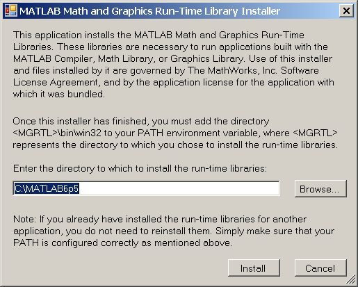

I would like to point the user to the environment variable editor using the command line
"C:\Windows\system32\rundll32" sysdm.cpl,EditEnvironmentVariables
in the plugin handbook page.
but I have no idea how that can be made a link target in the hyperlink region (due to the " signs in the link). Davide, any idea?
An alternative would be that the installer tests for the presence of dll and path entry and adds the entry if required.
This require to use an overload of the function that I've used inside the hyperlink region; I need to think how to unlock the feature without compromising those already existing....
P.S. I'm not sure that this command works after windows XP
Martin Kraska 22.08.2013 17:33:00
#19 Опубликовано: 22.08.2013 17:31:34
I am using Win7 and got the command line from the program manager after clicking through the system control hierarchy. Faster is to locate the dialog via search for "Umg", german for "env".
#20 Опубликовано: 23.08.2013 03:42:17
Updated. Now the installer is located within the plugin.
There is an user interaction issue. After updating the plugin and re-starting smath,
the installer dialog pops up and offers installation. You are also informed that you do not need installation if you already have the runtime environment installed. In this case it is natural that the user chooses [Cancel]. Then, however, the dialog pops up every time you launch smath.
If you choose [Install] even if you know that nothing needs to be installed, then suddenly the installer gets aware of that and just finishes and no more messages appear on start-up.
