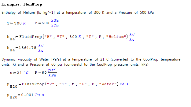

22.06.2014 10:18:04 [CreateUserFunction] FluidProp1 - [CoolPropMathcadWrapper.dll] [ Fluid, Property Name ] returns a fluid-specific parameter, where the parameter is not dependent on the fluid state
22.06.2014 10:18:04 [CreateUserFunction] FluidProp - [CoolPropMathcadWrapper.dll] [ Output Name, Input Name 1, Input Property 1, Input Name 2, Input Property 2, Fluid Name ] returns a fluid-specific parameter, where the parameter is dependent on the fluid state
22.06.2014 10:18:04 [CreateUserFunction] FluidPropI - [CoolPropMathcadWrapper.dll] [ Output Name, Input Name 1, Input Property 1, Input Name 2, Input Property 2, Fluid Name ] returns a fluid-specific parameter, where the parameter is dependent on the fluid state, using integer math for faster computation
22.06.2014 10:18:04 [CreateUserFunction] HAProp - [CoolPropMathcadWrapper.dll] [ Output Name, Input Name 1, Input Property 1, Input Name 2, Input Property 2, Input Name 3, Input Property 3 ] returns a parameter of humid air, where the parameter is dependent on the fluid state and humidity
22.06.2014 10:18:04 [CreateUserFunction] FluidPropsParams - [CoolPropMathcadWrapper.dll] [ string, name of the parameter to retrieve ] returns the value of the requested CoolProps parameter

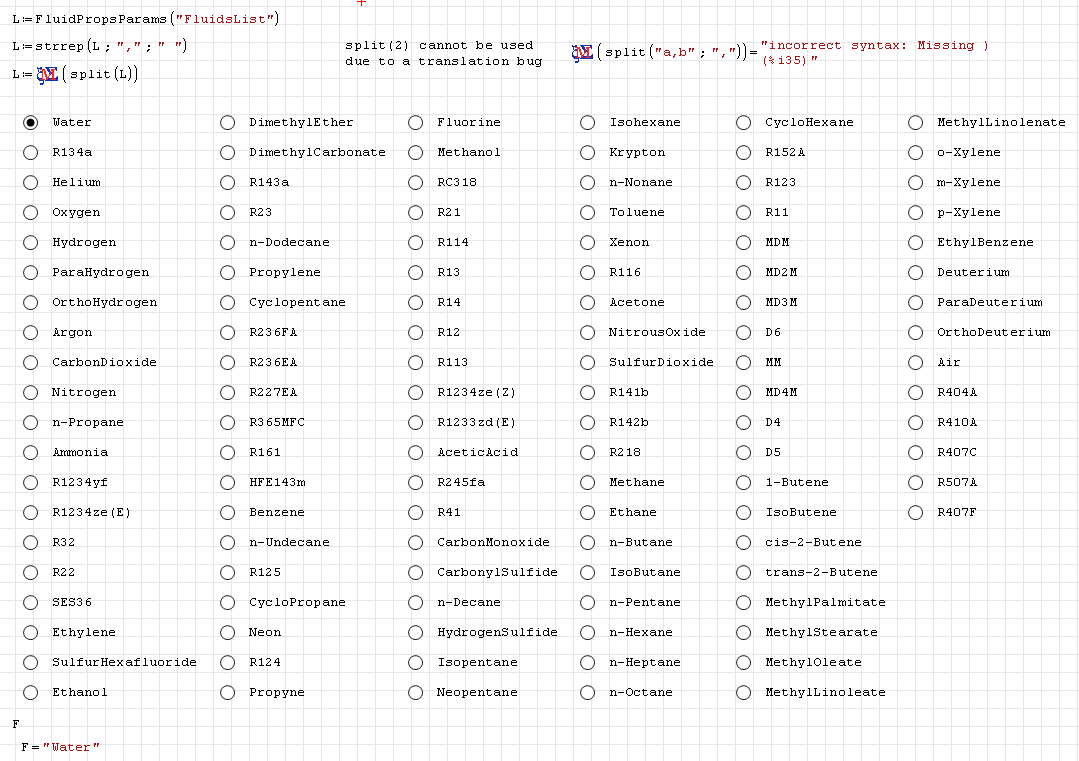

Now the library seems to work. Just strSplit() is undefined.
Maxima has a function split(string, delimiter), however, due to a translation bug only the default delimiter (space) works. Therefore, the kommas have to be replaced by spaces first.

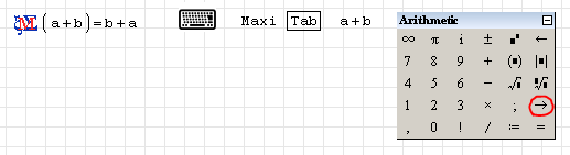

A quick test would be to type Maxima TAB a+b and evaluate that symbolically (-> button in the arithmetics palette).
Yet I do not expect Maxima to run, as it has never been tested under Linux in the development. Under linux, Maxima can hardly be run by starting maxima.bat, as done by the plugin. There might be a chance in wine, but I haven't heard of any success.
