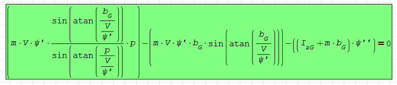

Hello to all
I solved this differential equation:
I wanted to know if the procedure I used is correct…
this is the .sm file… vel-imb.sm (25,61 КиБ) скачан 1047 раз(а).
Thanks in advance
#2 Опубликовано: 14.01.2020 16:50:33
Maybe it is correct. The solver you use is transmitted Unicode ?
not digestible as is. Why not stay Native Smath ODE Solver(s) ?
... as doctored/attached SS 6179
vel-imb Doctored Native Smath ODE solver(s).sm (26,39 КиБ) скачан 1147 раз(а).
