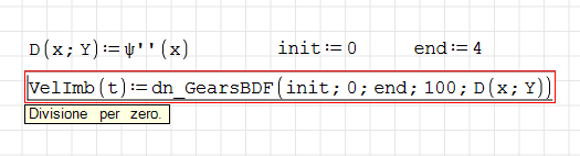

Hello to all.
I have a problem with the Smath function "dn_GearsBDF", it blocks the operation since giving me division by zero error.
How can I overcome this problem? MANOVRA (con parametri moto).sm (78,83 КиБ) скачан 1037 раз(а).
#2 Опубликовано: 31.01.2020 10:11:20
In dn_GearsBDF(init,0,end,100,D(x,Y)) replace zero with a small positive number (say 10^-10)

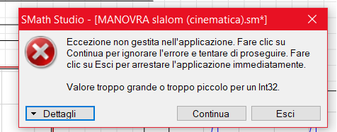

Instead if I have an error like: "value too big or too small for an Int32", how can I solve it?
Every time this error appears the program stops.

10^10 was probably too small, you have to see, how small x can be for your derivative ψ''(x) still being defined. 0.01 works.
#6 Опубликовано: 31.01.2020 14:30:34
... doctoring starts at red ... observe removing 10^14 at some trig [0].
lot more cleanup below ... can you write λ instead of l
