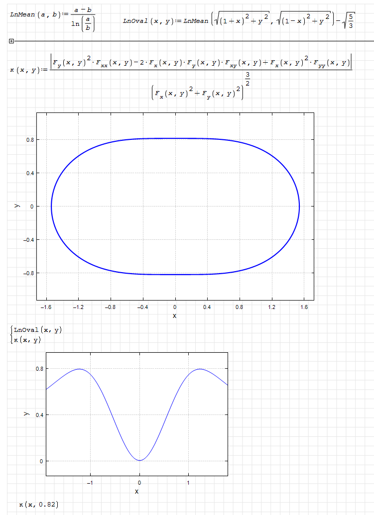

Why I can not Plot k(x, y)?
LnOval-Kappa.sm (170,49 КиБ) скачан 151 раз(а).

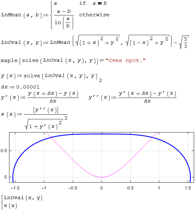

I think so
LnOval-Kappa.sm (38,24 КиБ) скачан 154 раз(а).
