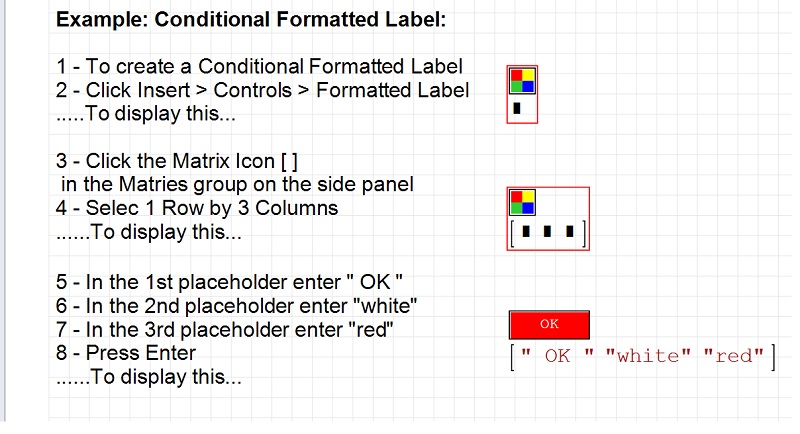

3 - I can't enter the square brackets at the beginning and end of the CFL defining... like...
[" OK " "white" "red"]
The CFL widget only lets me enter parentheses, not square brackets.
Is there a trick?

Is there a trick?
Use matrix, square brackets are matrix.

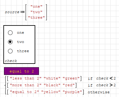

CFL with radiobuttons.sm (4,29 КиБ) скачан 1329 раз(а).

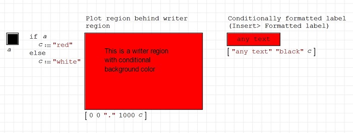

5 - How to add a clickable button to change the color of a Writer Region or a CFL?
(someone shared Background.sm with me that has this example)
1. Click Background to open the your pre-selected background(ssss...)
2. Click your selection
If your selection is active, it will background any Smath region.
Search "Bullets" in Samples from me, many memo code background.
#4 Опубликовано: 11.11.2021 16:40:02
Not related with neither topic nor 5th question.
I don't know a way to change color of a Writer region with a button.
You can use CFL for this scenario. CFL's purpose is this actually.
Change its content, foreground and background colors with variables.
And you can use Radio Buttons to alter a variable.
And use that variable value in CFL's if() or cases().

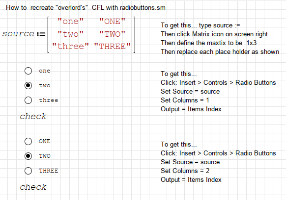

From your answer I was able to create this... (and thanks to Jean for encouraging me to explore CFL)
CF_Label_Tutorial.sm (4,35 КиБ) скачан 1281 раз(а).
You guys let me know if I got it right.
You got it right and made your first CFL.
But because it is not depended to an if() or cases(), now it is a static label.
Which is fine, but you can achieve that with a text region too.

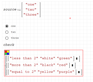

In overlord's post near the beginning of this thread he provided a sample...
CFL_with_radio_buttons.sm
I was trying to replicate it from scratch to see if I could do it...
- I created the 3 radio buttons...
- I created an "expression" with 3 placeholders vertically
- Then made a 1x2 matrix for each of those 3 placeholders
- Then made a 1x3 matrix for the first element in the 1x3 matrix
But it doesn't look the same as his... mine looks like this...
Question 1: How were the 3 lines in the CFL Created?
Question 2: How was the "if" statement created without an "else" ?
Also, when I downloaded and launched his example it told me he was using a newer SMath version
My SMath version is 0.99 (build 7822) Date 6/1/21. on Windows 10 Pro
Question 3: If there is a newer version/build would I install it on top of my existing version or first uninstall the current version of SMath?
Thanks for the help folks !
#9 Опубликовано: 15.11.2021 00:08:07
with cases() function.
With cases() function.
It is useful for multiple if situations.
No need for uninstall.
It will install on top of your SMath.
You settings and plugins shall be preserved.
You will need to uncheck beta exclude.

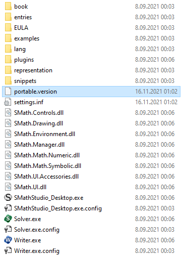

OK, I downloaded MathStudioDesktop.0_99_7921.Mono.tar.gz and used 7zip to get it all out into a folder a advised.
- I then created a empty file portable.version in the same directory
- I then double clicked SmathStudio_Desktop.exe to launch the program but... suprise...
... SMath Solver opened up. I'm unsure what Solver is unless it is the engine SMath uses to solve equations...

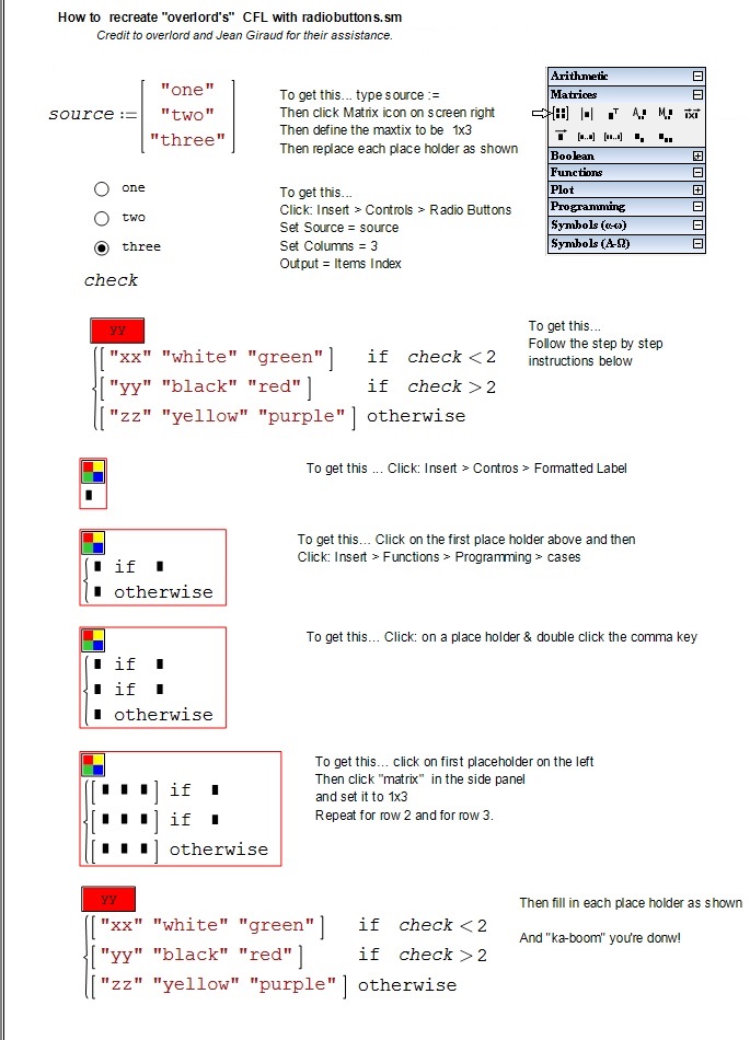

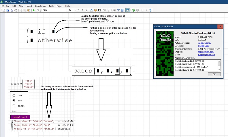

Question 3: Re cases function... used in overloards cfl_with_radiobuttons.sm early in this thread...
- I created a CFL and for the placeholder...
- I created a cases function but it only created one "if" case followed by "otherwise on the next line...
How to create more if cases? (I banged on it and made numerous attempts and scanned the custom functions thread... but no joy.)
Thanks
#13 Опубликовано: 15.11.2021 23:08:04
1. Get the basic if/otherwise [Cases]
2. Click on the the RHS place holder
3. Enter twice
#14 Опубликовано: 16.11.2021 01:14:48

Question 3: How to create more if cases?
Use arguments separator. "," or ";" which of you had set.

#16 Опубликовано: 16.11.2021 13:56:39
Question 1: I must be misinterpreting your instructions... can you advise?
On that place holder top right ... double click coma keyboard
Try it ... Cheers ... Jean.
#17 Опубликовано: 16.11.2021 14:46:09
Hit comma again, a new ifline shall be added to cases.
My argument separator is semicolon, so don't be confused.
According to your screenshot, yours is comma.
cases()
Question 2: must I delete the plugin and re-download/install it?
Not need to delete.
Plugins shall be automatic updated.
#18 Опубликовано: 16.11.2021 19:03:43
Fran Lee
Fran Lee
1 сообщений из 44 понравились пользователям.
Da Da!
(Credit to overlord and Jean Giraud for guiding me along the way.)
CFL_RadioButtons_Step_by_Step.sm (13,17 КиБ) скачан 1275 раз(а).
Hopefully this step-by-step will help other newbies.
PS Let me know if I made an error... but it looks to me like it's working.

#20 Опубликовано: 16.11.2021 21:45:13
This is not an error but it needs a clarification.
Setting column in radiobutton shall tell region which column shall be used for source.
In screenshot below you can see there are two columns of data.
If you set nothing or a nonexisting column, it will take first column.
If you set an existing column, it will use that particular column of the matrix.
