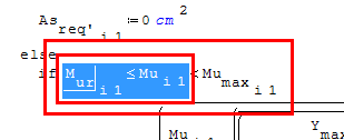

Hello Eduar,
nope, is not a bug; the problem is in your second boolean comparison. You have nested a boolean less or equal in the left argument of a boolean less -> the first returns 0 and 1, then this result is compared with the second argument of the boolean less (and here you were lucky because you got 1 - when you get 0 you can't see the error)
![2016-08-06 18_34_31-SMath Studio Desktop - [Documento1.sm].png](/ru-RU/files/Download/ATmBGx/2016-08-06-18_34_31-SMath-Studio-Desktop---[Documento1.sm].png)
You have to use the boolean AND to chain two boolean comparisons

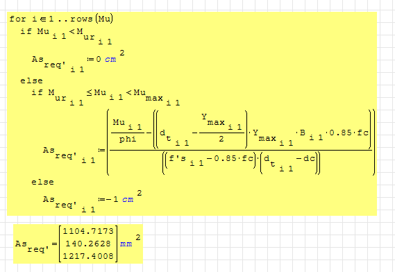

Hi Davide, your method works fine. But I still have problems with the resolution of the division.
I don't understand, the result is a vector.
Sorry for the question, I'm a newbie in Smath.

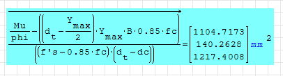

Don't worry; vectorize() is intended to apply to all the vectors' elements functions normally intended to work with scalars without using loops. In your case you have 2 ways:
1) use the loop; in this case vectorize() is not needed, remove it and everything should works

2) use vectorize(); in this case you have to remove all the references to the matrix elements. Note that in your case you have to pre-process or post-process the elements where Mu doesn't meets the requirements
