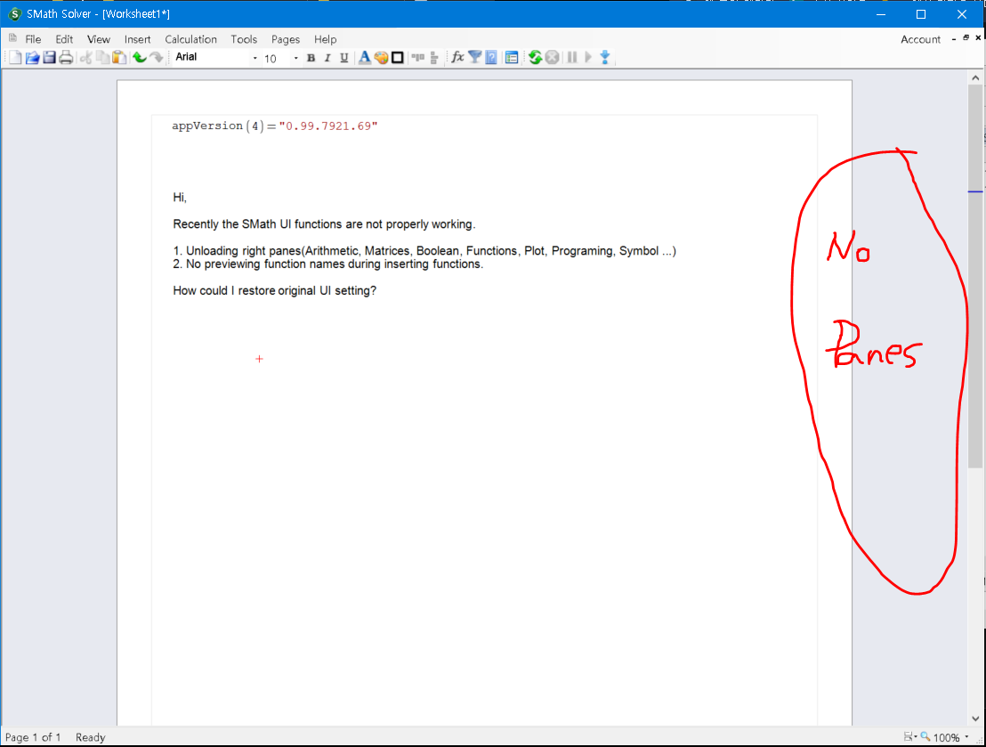

Recently the SMath UI functions are not properly working.
1. Unloading right panes(Arithmetic, Matrices, Boolean, Functions, Plot, Programing, Symbol ...)
2. No previewing function names during inserting functions.
How could I restore original UI setting?

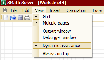

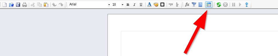

Hi. Use this button for hide/shows the panel and this option for autocompletion (dynamic assistance)

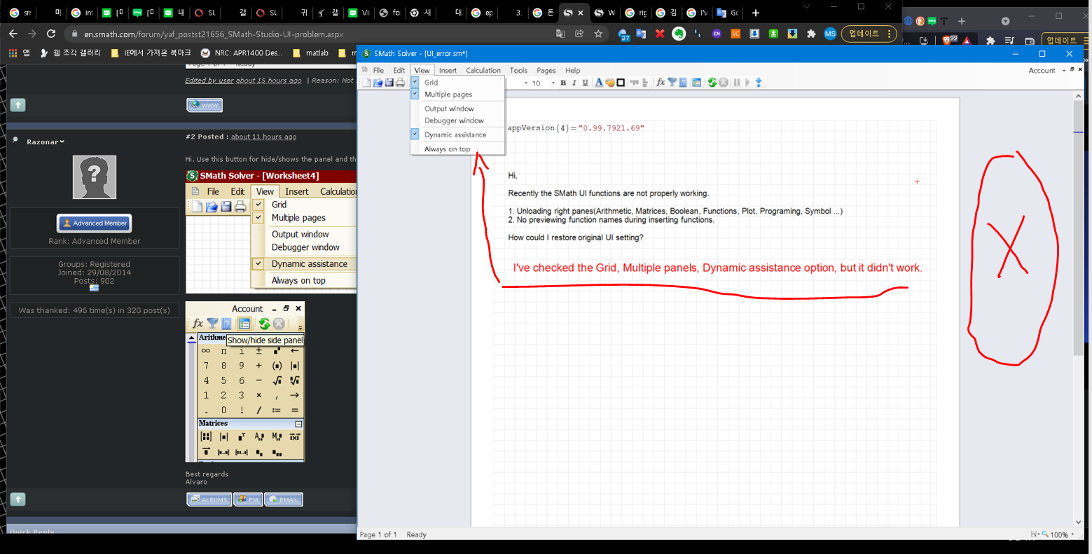

MSL
MSL
1 сообщений из 22 понравились пользователям.
Thank you for your advice.
I've tried set the multiple panel & dynamic assistance option, but it didn't work!
MS
#4 Опубликовано: 11.01.2022 07:03:57
have you tried to press the "show/hide side panel" button as suggested by Alvaro (Razonar)? Looks unactivated in both your screenshots.

My fault... I need to put appropriate button to the View menu as well. Will do.

#6 Опубликовано: 12.01.2022 01:23:50
MSL
MSL
Thank you!
It works! Everything is fine after click the button!
