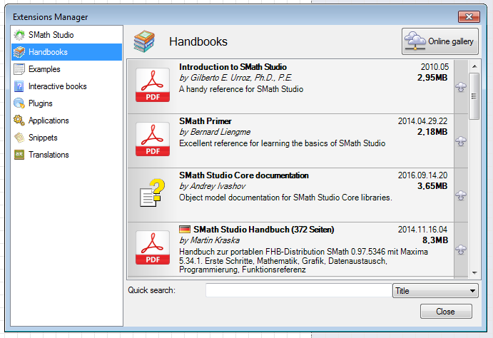

#4 Опубликовано: 28.05.2017 11:30:48
1 442 сообщений из 2 935 понравились пользователям.
Hello [userlink]Sjoerd[/userlink], welcome to our community

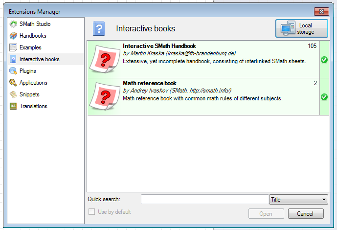

You can find several tutorials in the wiki, as well as in the extensions manager (Tool > Plugins > Handbooks [and/or] Interactive books - change the source from Local storage to Online Gallery)

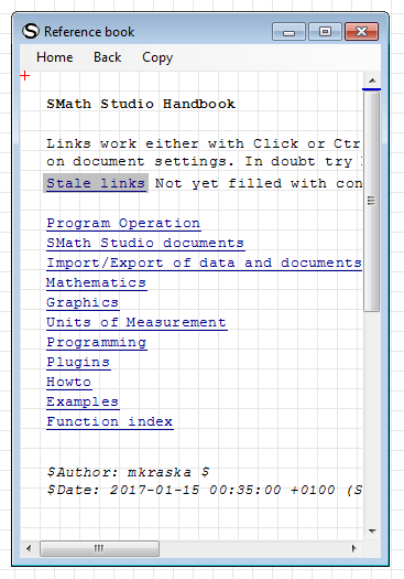

Interactive books, once flagged to be used as default, will be available through Help > Reference book
