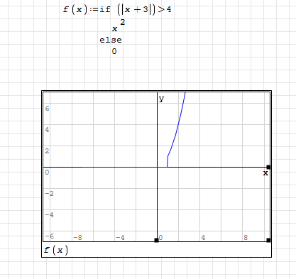

Plot issue?
Plot issue? - Shouldn't this plot from neg inf to -7 and 1 to positive inf? - Сообщения
#1 Опубликовано: 18.08.2020 00:57:32
PCPlayer24_7
PCPlayer24_7
Thanks for any response - j

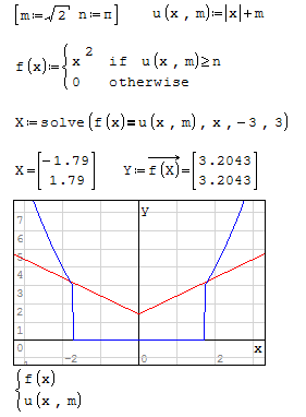

Hi. Try changing the zoom with the mouse wheel, or it and control or shift.
#3 Опубликовано: 18.08.2020 08:32:41

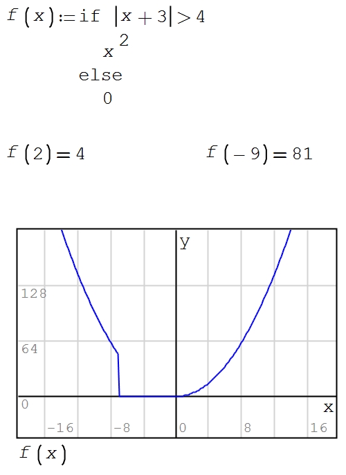

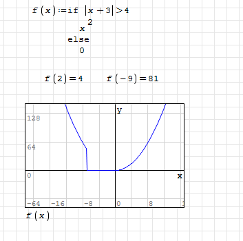

#4 Опубликовано: 18.08.2020 13:16:29
PCPlayer24_7
PCPlayer24_7
Razonar and Jean thanks for the quick replies, I tried Razonar's suggestion and it does fix the issue! I do like the idea to ensure f(2)=4 and f(-9)=81 to ensure the function works correctly.
Jean very helpful as well, I attempted to implement your example and haven't gotten it yet. Not sure if this is MathCad or SMath, I cannot get the "if" statement to work as you have it. So far I get only the "if" "else" from the programming toolbar only. The matrix's work though, so hopefully I get your example working in SMath soon.
