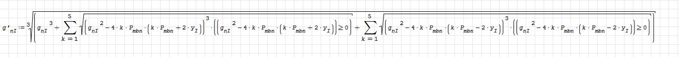

hi Folks, I am programming some equations and there is a requirement for a summation of terms, each term being a square root of a function of several variables. The method requires ignoring any negative results, i.e. where the square root of a negative number will lead to a complex number.
The terms are all have identical variables and it would be ideal if I can perform some operation on the general case term, so that the imaginary results just vanish.

hi folks, thanks for your contributions
the way I've solved my dilemma was to multiply each term by (X>0) so that whenever X is less than zero the sqrt(X*(X>0)) becomes zero.

Attach the *.sm document.
WroteAttach the *.sm document.
... do some effort:
split that monster, zap subscript, make minimalist like visiting doctor.
Page10 Split Monster.sm (476,26 КиБ) скачан 1475 раз(а).
