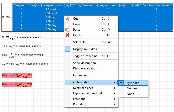

Dear all,
In a cam profile generation program, I perform some boolean operations with angular values (input in degrees).
I noticed some boolean operations fail due to a varying accuracy.
The file in attachment will clarify what I mean.
How can I make these values equal? Reduce the amount of significant numbers?
Thanks in advance for any feedback!

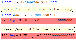

How can I make these values equal ?
If numerical arithmetic can't ... You can't.

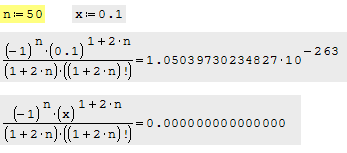

... differently puzzling: set n 49, 50

Choose symbolic optimization in the matrix definition.
janclaeys 12.05.2022 21:04:00, Davide Carpi 13.05.2022 05:29:00
Leave the main matrix numeric, explore Numeric/Symbolic in-situ
The two Boleans disagree ... IMHO, Numeric is the practical procedure.
