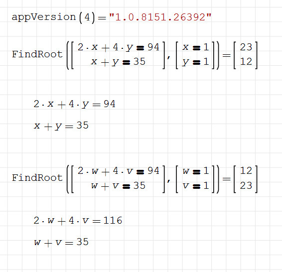

#2 Опубликовано: 11.05.2022 00:24:23
Hi. You must to sort the variables in the same order than Unknowns.
sergio 11.05.2022 04:02:00
#3 Опубликовано: 11.05.2022 01:49:05
John
John
0 сообщений из 12 понравились пользователям.
Hi, is there any rules for the order?

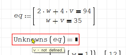

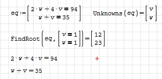

#4 Опубликовано: 11.05.2022 03:32:40
Hi. You can't redefine Unknowns. Well, you can, but isn't the best idea. Unknowns is a function in the same plugin than FindRoots, SpecialSolvers. I don't know the internals of the plugin. My guess that the general rule is sort the variable names in lexical order, but if the name has unicode characters or some unusual ASCII character, it is best to make sure of the order to follow by evaluating Unknows(eq).

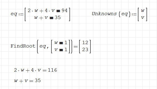

#5 Опубликовано: 11.05.2022 05:30:29
John
John
okay, I got it. but a new question, why I can't got the result as your picture?
would you mind post the sample sm file ?
Thanks a lot!
John
#6 Опубликовано: 11.05.2022 06:22:01
SMath have two "=": Numerical and Symbolical. With numerical evaluation you can only obtain numerical values, that is, without undefined variables. Rigth click to change it to symbolic equals, or use Ctrl+period instead "=", or click symbolic evaluation in the right panel.

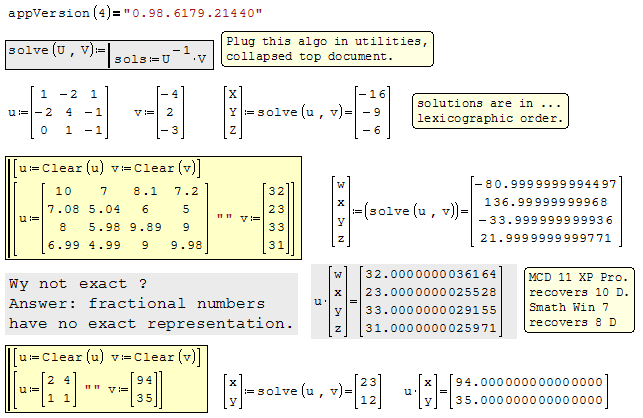

OBSERVE ... so much from so little
Solve Algebraic, NON-Algebraic Read first.sm (69,81 КиБ) скачан 1284 раз(а).
#9 Опубликовано: 11.05.2022 08:56:57
This multi solve companion is 3 x 3
Make it 2 x 2 ... n x n ... as per your project.
Solve Algebraic, MULTISOLVE Companions.sm (17,86 КиБ) скачан 1312 раз(а).

#11 Опубликовано: 12.05.2022 08:44:12
For your example, make it algo style for local infinite use.
Observe ... sols:=U^-1*V is universal outside of Smath Plugin(s)
... your question about order of vars
solutions are by convention in descending order of the pair wise u, v
no matter the names you give.
I can't explain the decimals difference between MCD 11/Smath.
There are other constants that can't be found exactly ...
Pitot constant, Goat radius constant ...
That remark applies to any solvers [Smath and wrt any CAS]
The U^1*V is the core component of the Cholesky solver
as applied to fitting model function to a data set.
In that case, best fit is obtained by iterating the Genfit.
Chers ... Jean.

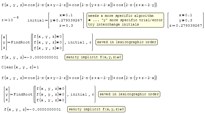

#12 Опубликовано: 12.05.2022 09:46:19
... here, you can push the cork in the bottle to accommodate irrational pi.
as well ignore epsilon.
#13 Опубликовано: 12.05.2022 10:11:31
... as it looks, the max I could push the cork in the bottle
y≡0.279339266990994 ... sanity f(x,y,z)=-0.000000000001344
Confirms impossible exactly solving irrational numbers.
