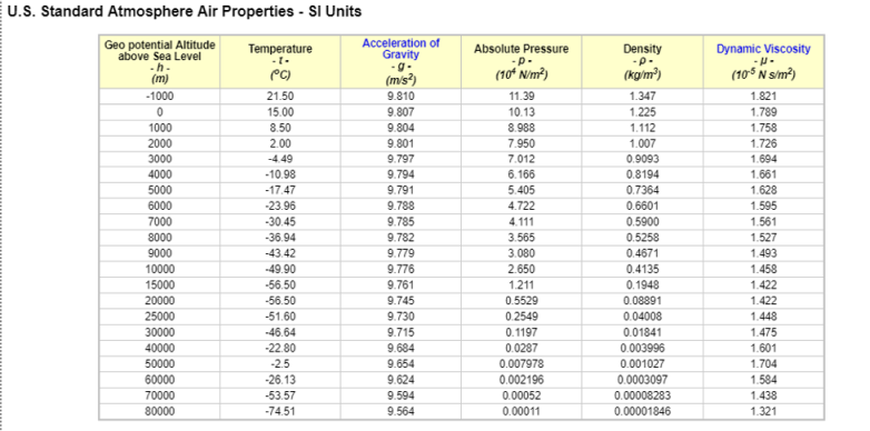

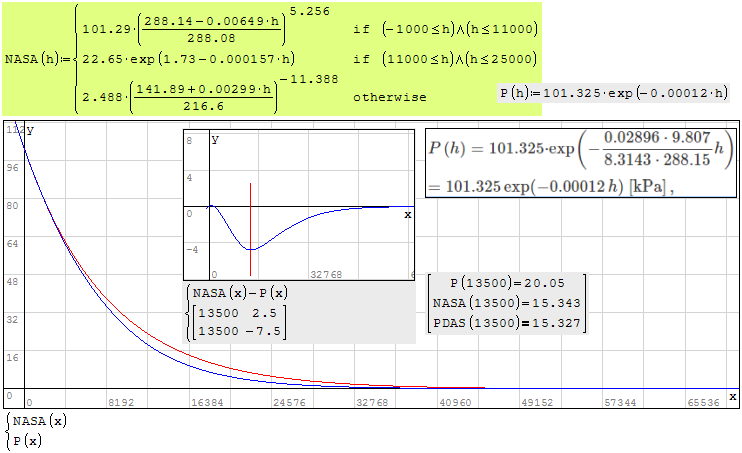

The NASA(h) is recent to me.
Curiously enough, they arrived at the same conclusion years ago:
Theodore, Jean, [Ralph ?] that altitude is not homogeneous
and represented by rational/expDecay/rational segments.
In this document, we just trust NASA as an act of faith !
To determine the altitude, kPa is the measured.
You may probably use the static from the Pitot tube or else
accurate barometric device... local barometric is headache.
Given as is if any useful for your journey in air.
Inst_ISA [km_kPa] NASA airplane Copy.sm (138,24 КиБ) скачан 1016 раз(а).

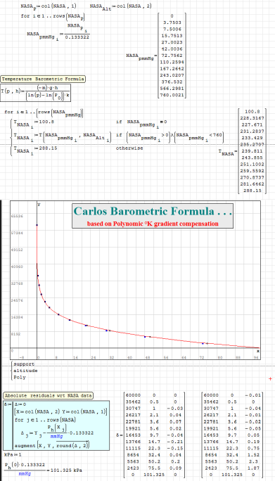

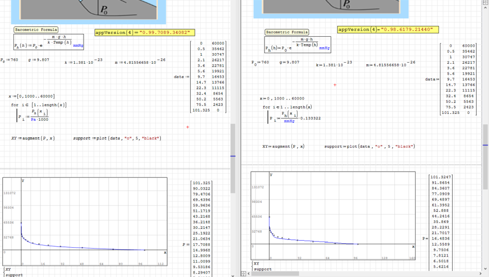

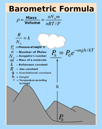

Hello Jean:
The atmospheric conditions are very changeable, so it could be said that
the data are only accurate at the time they are taken.
The density of the air changes with the temperature, and the
temperature changes with the altitude, then the barometric pressure also changes.
There is a barometric formula to calculate the air pressure according to the
altitude, to which I have included the temperature function according
to the altitude to try to make the calculation more accurate.
Barometrit_Formula_Aire_CBG.sm (423,21 КиБ) скачан 1202 раз(а).

Thanks Carlos,
Unfortunately, SS 6179 can't open the latest SS Beta you are using,
can't read the temperature correction. Math 24 barometric is in fact
so much erroneous vs PDAS, NASA(h) it shouldn't be published as given.

I do not know why SS6179 transforms the units differently to SS7089 and gives slightly different results.
Here you have the file in the SS6179 version.
Barometric_Formula_Air_6179.sm (423,31 КиБ) скачан 1225 раз(а).

Thanks Carlos for the SS6179 document.
Polynomic is new to me, more applications expected.
As applied to Barometric, the more abundant data set gives results
very close to NASA. The last step is the [m] altitude vs measured kPa.
Something similar to the other document ... RemToDo.
The P(h) has an inverse RootsOf, of no interest for minimal calculator.
Inst_ISA Barometric Formula [Carlos].sm (455,05 КиБ) скачан 1062 раз(а).

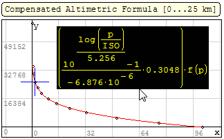

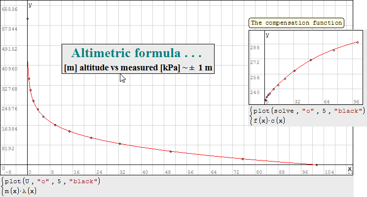

... Here is Carlos . . . an un-ambiguous altimetric formula.
1. NASA solved for well distributed points
2. The inverse Barometric solved for the the compensation parameter.
3. Final altimetric at least up to 40 km
4. Accuracy depends upon NASA itself and kPa resolution
Will read your latest attachment ... Jean
Inst_ISA Altimetric Formula Copy.sm (32,91 КиБ) скачан 1140 раз(а).
#11 Опубликовано: 14.06.2019 19:46:37
The Altimetric session ends here for quite a while unless more revelation.
Formula page 7/7 ... auto-compensated on actual/local ISO [101.325 kPa].
The mutual conformity wrt solved NASA(h) is stricking of realism.
Comments/suggestions ... welcome.
Inst_ISA Altimetric Formula Copy.sm (131,19 КиБ) скачан 1175 раз(а).

The Altimetric session still has a little more chapter, since the
Barometric Formula can be adjusted for the variable of gravity
Inst_ISA Altimetric Formula Gravity.sm (227,89 КиБ) скачан 1242 раз(а).

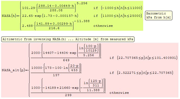

... last brick in the wall.
1. NASA(h) Barometric ... kPa given altitude (h)
4. Nasa(p) Altimetric ... altitude (h) given kPa
................sections [2, 3] not needed for publishing
though guide line for discrete solve.
Just need the dual formulas [image below]
Inst_ISA Barometric_Altimetric Companion.sm (91,43 КиБ) скачан 1172 раз(а).

1. Cold airport °C landing altitude correction added
2. Spline TableIII added [observe typo in the published document]
Inst_ISA Barometric_Altimetric Companion.sm (542,49 КиБ) скачан 1270 раз(а).
