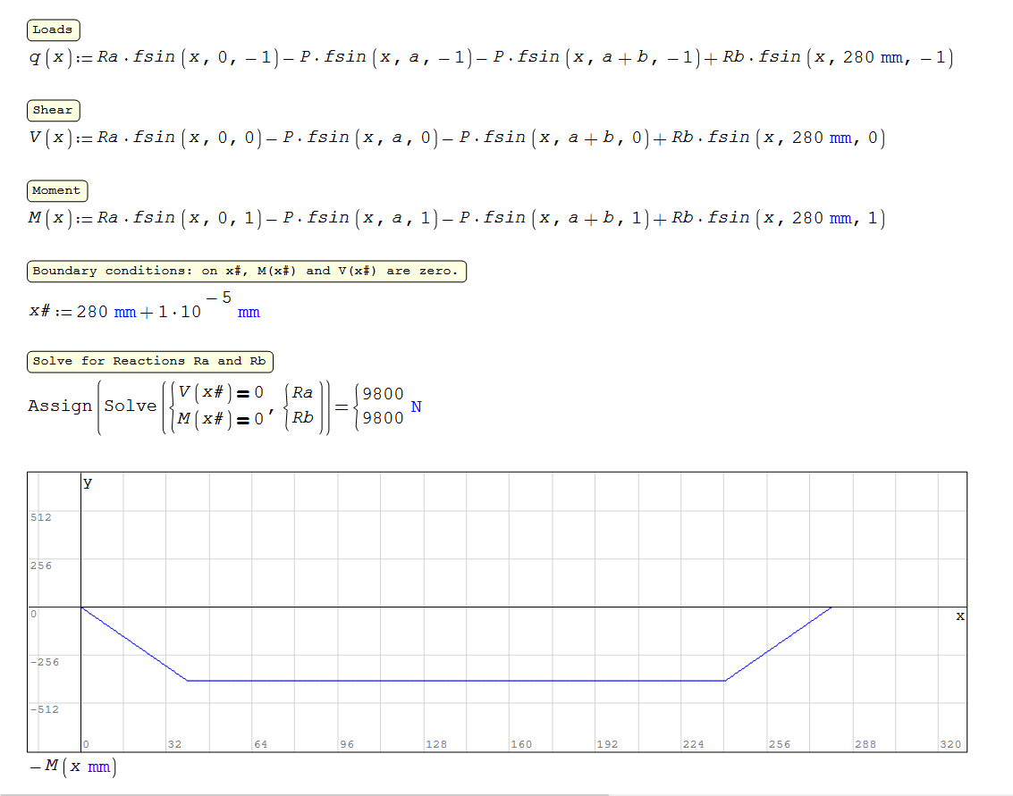

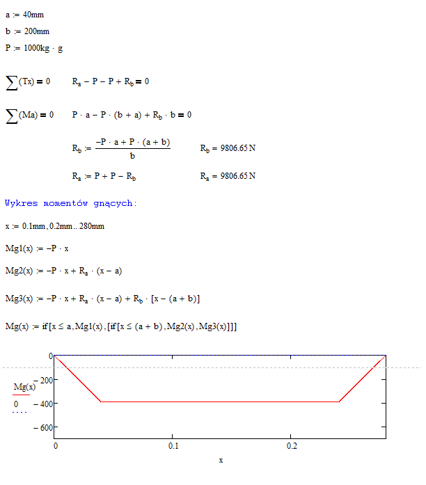

Hi everyone. In work I used MathCad, but when I heared about Smath Studio - I wanna try it at home. But..... I have problem. I want to rewrite one calculation sheet from MathCad to Smath.
Here is fragment from MathCad: 1.PNG
I try to rewrite the same calculation to Smath but I can't correctly generate plot: 2.PNG
What I do wrong? I can't find error. BTW: I can't apply "x" range like I made it in MathCad.Can someone help me? Maybe make simple working file with solution on my problem? I already don't have any idea... I try for few days after works.

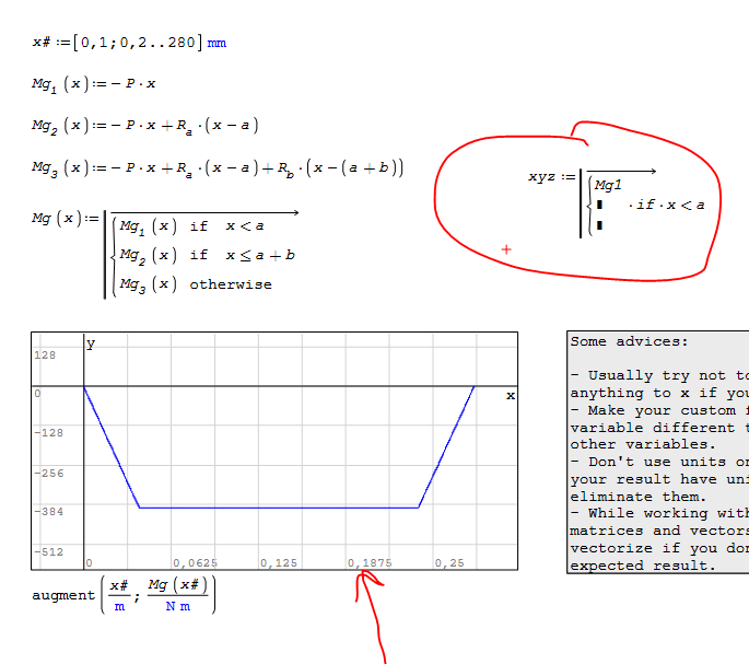

Here is your worksheet.
Smath don't have mathcad x define while plotting.
We generally augment x with results.
While unit version shall plot too, better to make eliminating a habbit.
PS: updated post with cases(), a simpler and easier if() replacement.

How you define Mg? This arrow came from?
#4 Опубликовано: 19.07.2021 15:21:33
Thanks MAN! Now I have starting point
That is vectorize() function.
You can either type it as a function or select from toolbar.

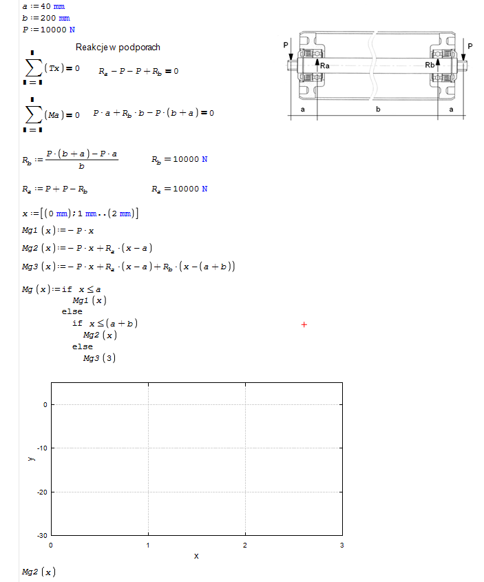

I wanna to have mm on plot "x". How can I change that?

I try to make Mg(x) fragment on my own... How you done this?
Fragment as suggested 3 different ways.
No system will respond to invented code.

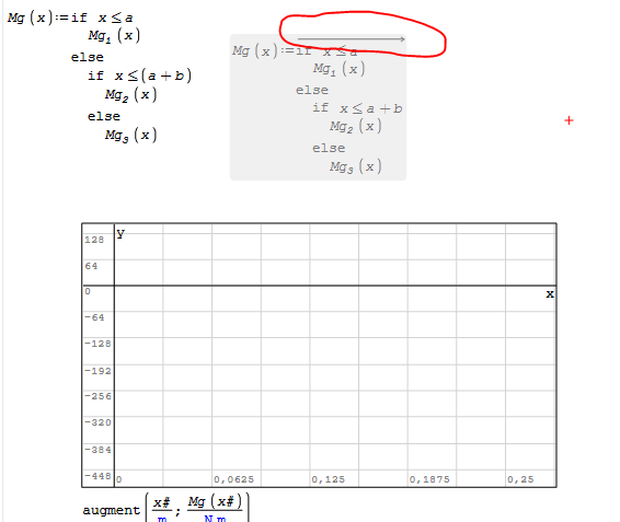

I'm try to understeund how somebody write it... I can't reproduce that record.
I mean, I don't know in what order I must click specific function to get this "function"
#10 Опубликовано: 27.07.2021 14:50:21
The symbolic stuff is, from outer to inner:
line(
vectorize(
cases(
cases is from "custom functions" plugin, therefore to have it in your functions you have to install the extension first.
line and vectorize are available also in the toolboxes on RHS of the worksheet area.
About unit scaling, divide by 'mm instead of 'm (a mm is 1/1000 m, so the output will be magnified by a 10E3 factor)

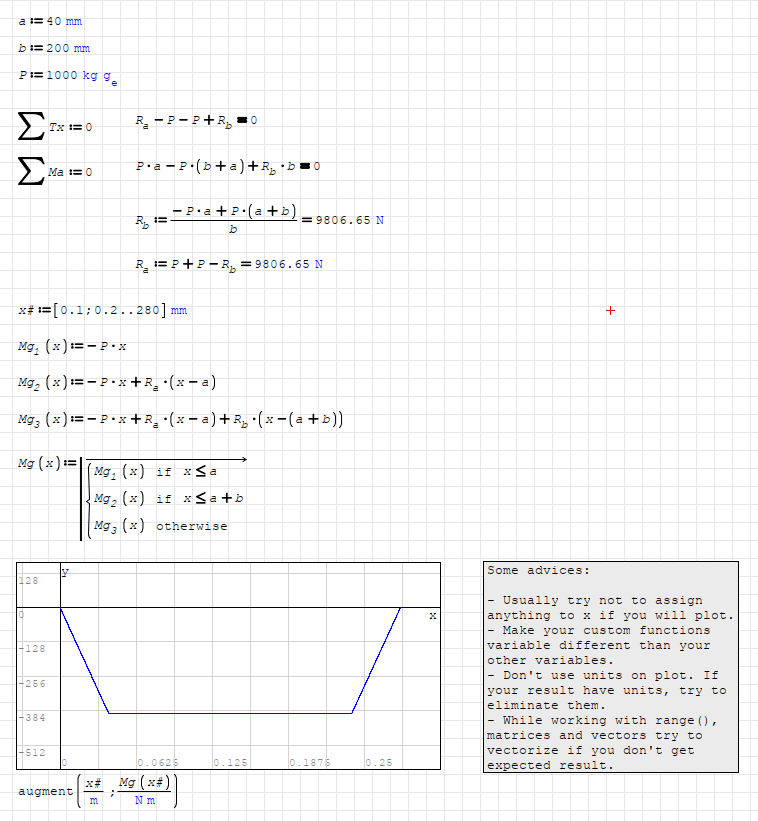

Here is the 4th code ... set 'n' as you wish to fragment.

Davide, that is what I'm talking about. Thanks man!
