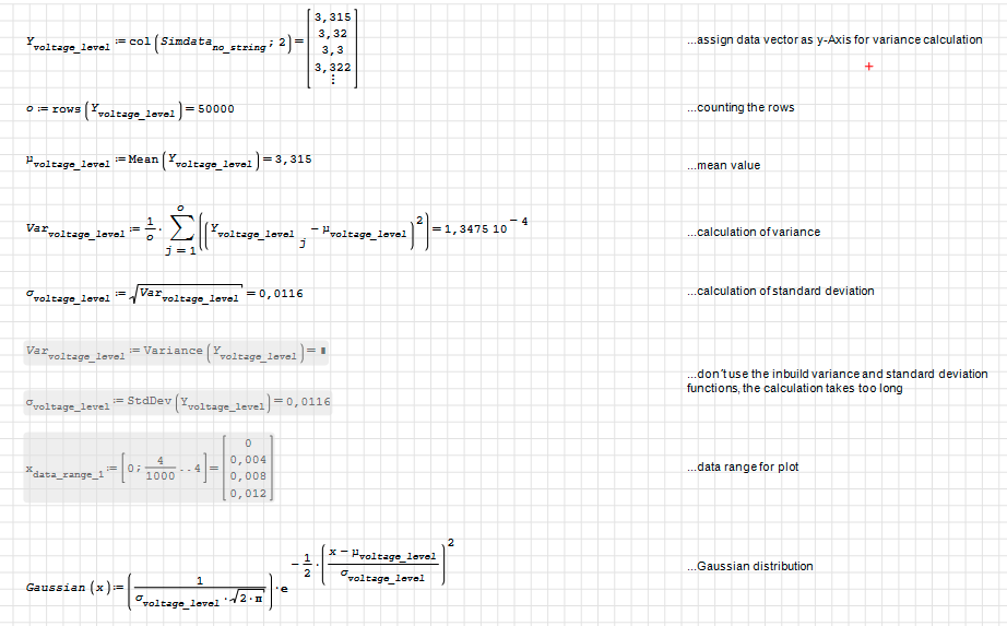

With import file functions you might need to set the optimization to numeric to speed up the loading.
Optimizations were all set to numeric - did not help. What helped was that I substituted the statistic function variance() and StdDev with the original/native formula for the variance and standard deviation.
This speeds it up to around 1s.
Don´t know what happens inside the functions of the statistic plugin but it is very slow.
Thanks
Thanks
I have noticed the same thing; the built-in function for standard deviation takes forever but the calculation runs pretty quickly if I just code in the formula in the worksheet.
Confirmed, the bottleneck seems to be in the final ouput processing to return the result from the equation [f.e. 1/{n-1}*sum(((el(X,i)-mean)^2),i,1,n)) for StdDev]; no idea not sure what could be the cause...
