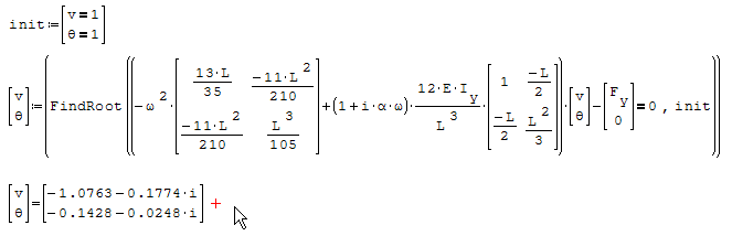

#4 Опубликовано: 13.06.2023 09:29:58
I think the problem is that the units don't match.
Compare the units of the components of the two terms inside the brackets
that multiply the [v; theta] vector.
FindRoots ignores Units. Code the image first.
Solve FindRoots Complex Forum.sm (11,09 КиБ) скачан 1357 раз(а).

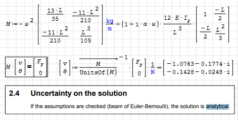

#8 Опубликовано: 13.06.2023 16:34:30
Besides correction of the unit mismatch, Solve seems to want the matrix equation in homogeneous form.
Matrix equation_Kr.sm (14,1 КиБ) скачан 1287 раз(а).

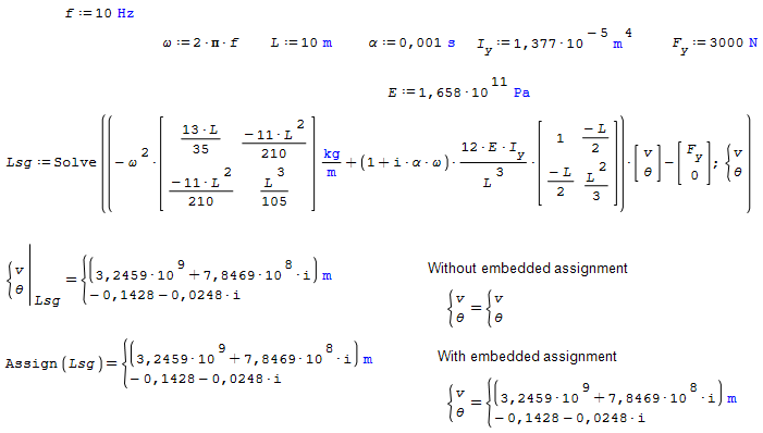

#9 Опубликовано: 13.06.2023 18:25:48
1 124 сообщений из 1 796 понравились пользователям.
Hi. Another way.
