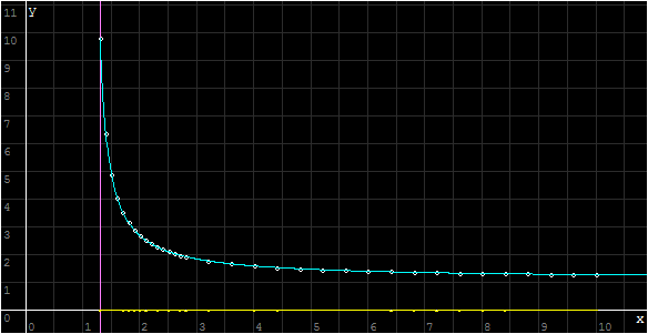

WroteThis is an approach, maybe Jean or Alvaro, can Doctor it
Hello Carlos, maybe like this ... solve(2) to let the solver breath freely.

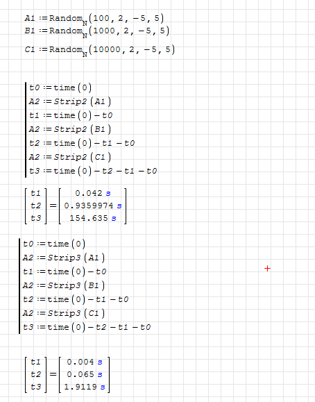

See attached. I've modified your strip2() algorithm [See Strip3()]. On my PC it performs same calculations ~10x faster. Might help with large data sets.
PileRedux_Factor_CBG [1]_alyles.sm (31,33 КиБ) скачан 1311 раз(а).
WroteHi Jean,
Thanks alyles ... Good job !

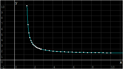

WroteHola Carlos. This is another approach.

I make the next comment. In none of the 3 graphs that you show,
the scale of the "Y" axis, reaches the value 10, so I think,
it would be necessary to expand the scale to verify that the curves are correct

WroteI make the next comment. In none of the 3 graphs that you show,
Carlos, the limits are the limits of the solver.
I refactored a bit to understand myself easier,
played a bit the lower limits [A5, A6] ... bingo !

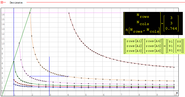

Hola Carlos,
Few more things to improve presentation ...
Decimate part of the A1, A2,A3 . Confirm project is valid
particularly withe 'z' target in A solvers.
Project PileRedux_Factor_CBG [1].sm (30,8 КиБ) скачан 1305 раз(а).

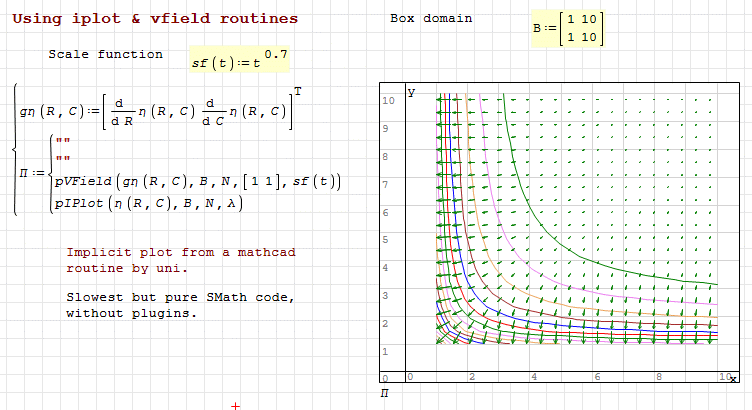

Wrote... I make the next comment. In none of the 3 graphs that you show,
Hola Carlos. Maxima shows 10 for both axis, IPlotSolve, by construction, only can take two vectors (x or y and lambda) but not 3 (x and y and lambda).
For pIPlot and pVField, just change the Box in 'B'. I take columns only one to five.
WroteHola Carlos,
... decimated plots are lot more presentable.
At this point, for a specific target solution
easy to get a Thiele analytical formulation.
In the mean time, I will test some decay model.
Project PileRedux_Factor_CBG [1].sm (46,98 КиБ) скачан 1260 раз(а).

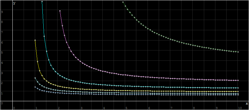

WroteIn the mean time, I will test some decay model.
... a pretty good fit. More models to be explored.
Project PileRedux_Factor_CBG [1] Rational Fit.sm (58,08 КиБ) скачан 1299 раз(а).
Wrote... a pretty good fit. More models to be explored.
... patience is rewarded, an exact fit
considering the inexact solver solutions.
Project PileRedux_Factor_CBG [1] Exact Homographic.sm (50,54 КиБ) скачан 1287 раз(а).
