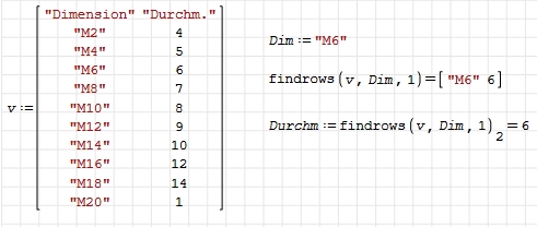

Hallo guys,
is there a similar function in smath for sverweis like in Mathcad or Excel?
Searching for a variable in a matrix and give back a certain number in that row?
Thank you br Stefan
#2 Опубликовано: 01.09.2021 15:05:01
Hi. You have findrows in SMath
Stefan Müller 01.09.2021 15:08:00

o perfect thank you!!!!

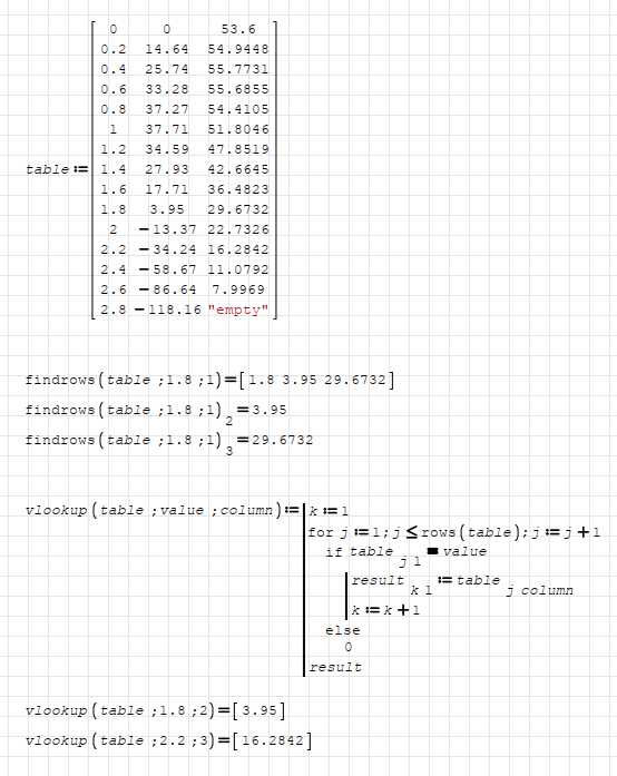

#4 Опубликовано: 01.09.2021 15:19:23
You can either use findrows() as Razonar mentioned.
Or you can use custom written vlookup() function uploaded before.
But I would stick with findrows() if I had to choose.
Worksheet1.sm (8,43 КиБ) скачан 1243 раз(а).
