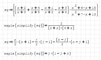

How to simplify expression

#1 Опубликовано: 07.09.2024 21:50:31

I bet Maxima plugin can do this too.

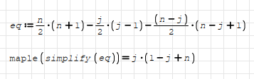

Why maple failed?
#4 Опубликовано: 16.12.2024 12:12:56
Is it possible you didn't set result optimization as symbolic?
