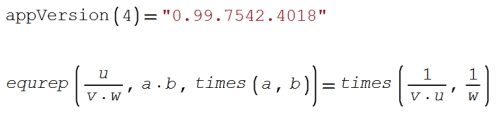

Hi. Thanks! Very much!
"equrep() function supports variables/functions replacements now."
Any example about what that means?

Also, I see that this error persists:
Yes, this is a main reason why I can't release stable version of SMath Studio now. I'm working on this issue right now.
Issue is fixed in the latest stable version I have just published. equrep() made less powerful, so it will leave an equation as is in cases where error is possible. Like your example.
This is temporary solution but it is required to continue development without serious stoppers. In future I will continue working to make symbolic engine more smart.
I post that question because interpret that then equrep works replacing f by sin in this example: "equrep(3+f(x),f,sin)=3+f(x)" but now I see that the correct way is "equrep(3+f(x),f(a),sin(a))=3+sin(x)"
