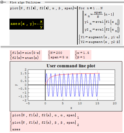

... native SS 6179 ... sorry but I have no interest *.svg
Stand alone user command line is more my cup of tea.

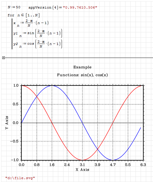

- updated to DISLIN 11.3.3 (799 functions);
- refactored.
Цитата
Grant of Free Usage
You are allowed to use DISLIN for free. Either as a private person or in a
commercial or non-commercial environment. There are no limitations.
Click to enlarge
DISLIN. Example 1.sm (95,34 КиБ) скачан 2203 раз(а).
DISLIN. Example 1.pdf (287,2 КиБ) скачан 1525 раз(а).
Andrey Ivashov 05.11.2020 19:12:00, NDTM Amarasekera 05.11.2020 22:32:00
