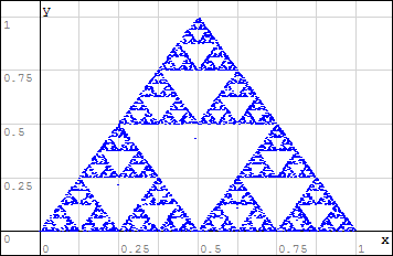

#2 Опубликовано: 03.03.2016 10:38:21
The nice and clean Sierpinski from Andrey,
I don't have the faintest idea how to build.
This one works well. X_Y plot refuses to plot.
Pattern Sierpinski.sm (12,12 КиБ) скачан 1431 раз(а).

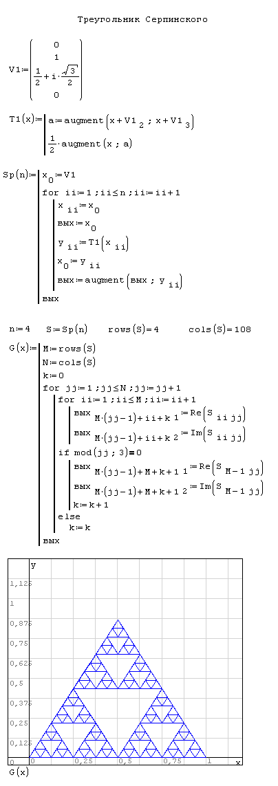

#4 Опубликовано: 04.03.2016 13:12:59
Both files are working for me.
It seems that the algorithms are not the same.
The principle is this:
Thanks Ioan,
You are right: it's plotted using my [not mine]
algorithm, infinite or very high iterations and
plotted pixels. Smath plot points plot many adjacent
pixels [Mathcad as well] thus not clean plot
