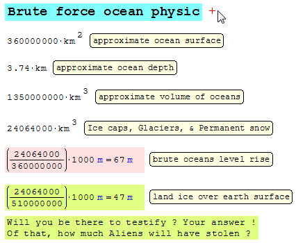

There more details not accounted.

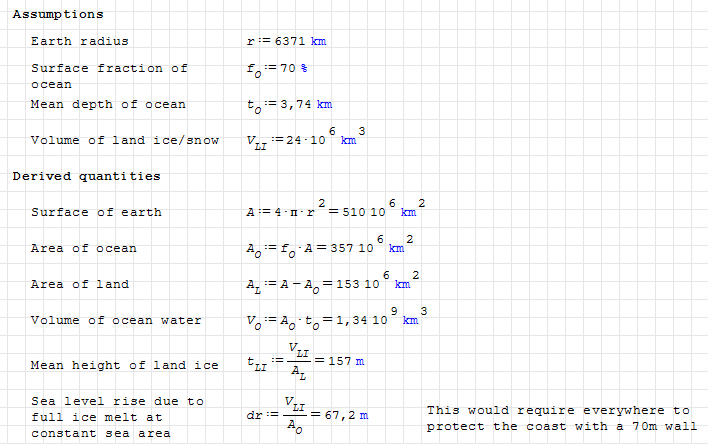

Use of units and variables -> more self documenting.
ocean.sm (10,02 КиБ) скачан 1256 раз(а).

I vote not for a wall nor containment dam (even before you need to ask it to a Nederland engineer), but for dredging the sea floor. Can you estimate the energy for do that: Dredge 24E6 km3 of sand (or whatever there is at the sea bottom) and transport it somewhere not to far? Just assume no problem about where to locate it.
