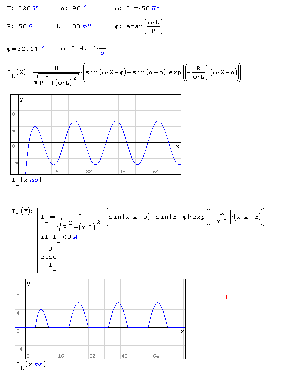

Again, I am not quite sure what did you want to do, sorry.
Nevertheless, I will try to give you an answer. If this does not solve your problem, just be more specific please.
Here it is:
Btw, it is advisable to avoid "x" as a function argument in the function definition (I used "X" here) when you try to make plots ("x" is reserved for 2D plots and "x","y" for 3D plots. For instance, this will not work. In some cases this will work, but for this particular one it does not (Do not know why).
Here it is:

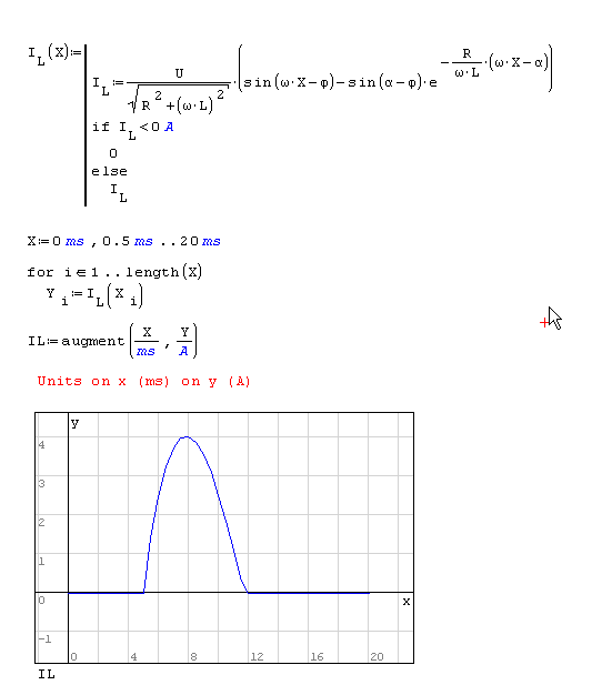

At first i will try to specific more the behavior i need.
The Equation for IL let you calculate how current flows in a controlled transformer rectifier circuit with center tap.
But it is only valid for the period interval (in this case from 0 to 20ms because of the 50Hz Sinus). Then the fist Swing
you see in the Plot will be periodical repeated, if alpha doesn't change.
Alpha is the point were the Switch is turned on.
Because it is a two pulsed rectifier in the next step i will need to add the swing for alpha+pi/2, but i have at this time
enough problems with the first swing

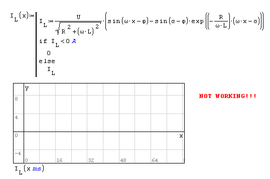

As you see below, i have copied your resolution but it doesn't work at all.
No error message is given from SMath.
I'm yousing the stable release, should i switch to the actual beta?

I think you should, there are some fixes in the recent beta.
Btw, you can make a plot this way (plotting a matrix with two columns)
WroteI'm yousing the stable release, should i switch to the actual beta?
