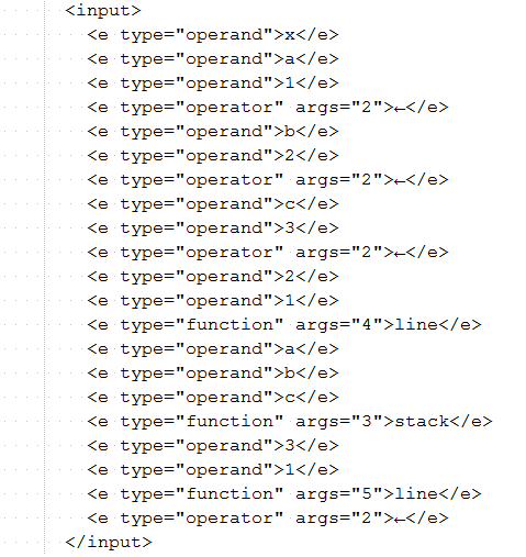

I create a lot of multiline functions. But SMath does not yet have the ability to insert or delete lines from the function. As my functions evolve I have to add lines of code between lines. I've found the easiest way to do this is to edit the SMath sm file.

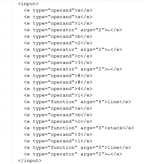

To add a line of code simply expand the bottom of the LINE, where LINE is the SMath multiline command. A blank line will be inserted as reprented by the blackened box. Save the SMath file.

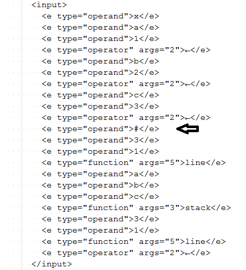

Open the SMath file with your text editor. Locate the blank line # and move it up.
Now you can insert the new code line.
Adding lines is easy. Any number of lines can be added. Deleting lines is a bit more complicated. First delete the line in the multiline function. Save the SMath file. Open the file in your text editor and locate the # and delete it. The next thing you have to do is adjust the number of arguments for each SMath function.
Determining the number of places the number of arguments needs to be adjusted gets tricky. But I've found it saves me a lot of time rather than moving every line up or down.
This is not something for the weak of heart. I've crashed SMath a few times by not adjusting the number of arguments properly but ultimately I've been able to achieve what I want. Just be careful and do it on a backup not the original, in case you have to go back to a file that works.

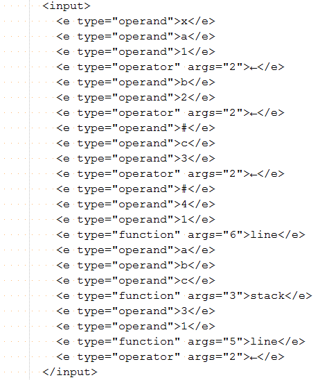

PS. It just struck me of an easier way to delete lines.
Delete the commands in the line you want to delete. Add a new line at the bottom. Edit the SMath file and move the # to the other #
Edit SMath file move #
To other #
In SMath simply collapse the LINE to remove the deleted lines. This way let SMath adjust the argument count.
