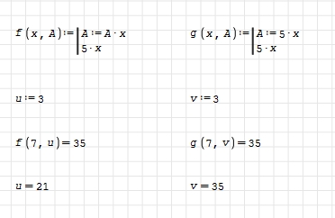

Modifying global variables in user defined function
Modifying global variables in user defined function - I am trying to modify a global variable inside a function passed as an argument. - Сообщения

I am expecting the global variable value to change and maintain the change after exiting the function.
Example

Hi. The only way I know for a function to modify a variable is to pass it by reference to the function.

#4 Опубликовано: 01.07.2021 00:12:28
Hi.
example_by_ref.sm (4,86 КиБ) скачан 1260 раз(а).

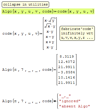

#5 Опубликовано: 01.07.2021 08:35:00
Native Smath has the exceptional feature of being algo style.
You can do what you want from in-situ command line.
Oscar Campo 01.07.2021 10:50:00
