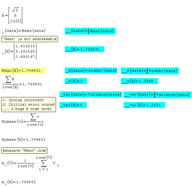

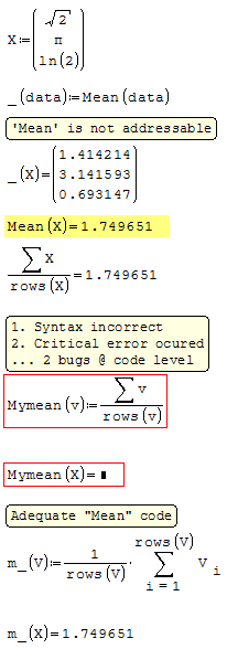

#1 Опубликовано: 08.12.2016 11:33:38
If not corrected since 5346 [official release].

#2 Опубликовано: 08.12.2016 14:11:37
It seems not quite yet
StdDev(), Variance() will give zero values. Quite strange .
Davide Carpi 08.12.2016 19:38:00
#3 Опубликовано: 08.12.2016 19:38:14
Thank you guys, I'll fix these functions ASAP
As shown in Radovan's screenshot, the second bug is fixed in current version of SS.

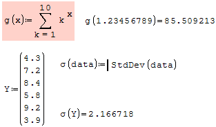

#4 Опубликовано: 09.12.2016 03:22:27
You are welcome Davide, and thank you
By the way, It seems there are some more functions affected by this bug (like Median(), Mode() etc.). I do not know how many of them might be.
P.S. It crossed my mind this bug as well - summation problem. Are these bugs connected in any way? In both situations you have to use line() environment and the calculation is Ok then.
#5 Опубликовано: 09.12.2016 10:55:23
Quite right Radovan,
The stat package understands local line definition.
5346 does not suffer the iterator problem you attached.
