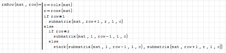

I am using a matrix for data input, which will go into a function. Is there a way to delete an entire row or column (not at the end of the matrix)?
Or maybe there is a better way to input data rather than using a matrix?
#2 Опубликовано: 20.11.2014 15:51:49
If I remember correctly there is some snippet about this task in the forum, even if I can't find it...
Anyway this should help (in the same way you can delete a column or add a row/column)
edit: another way Language-Integrated Query (Linq)

Thanks to both of you for this.
Sorry for the delayed response.
