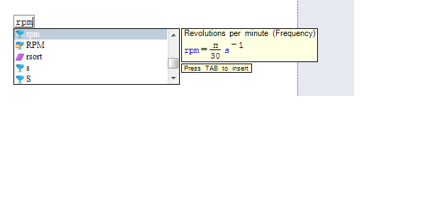

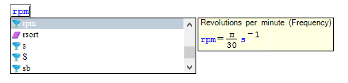

#2 Опубликовано: 11.04.2018 10:38:51
please read here (SS-2395) (you can vote and comment it), here or here (and other...)
base unit of a revolution is coded as 2pi radians (not 1), hence the multiplication factor.
Arie 11.04.2018 10:42:00
#3 Опубликовано: 11.04.2018 10:41:00
Arie
Arie
This is because the standard unit in SMath for rotation is radian = 2*pi which is ~6.28. If you look at the definition of rpm it is pi/30 1/s or 2*pi/60.
In order to get the right result you need to divide by 2*pi. What i would suggest is creating your own unit for RPMs as done in the attached.
