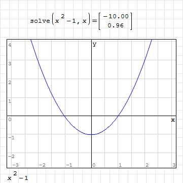

Hello, please tell me what is wrong with this function?

#2 Опубликовано: 16.10.2018 06:38:47

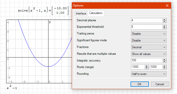

The solution method is numeric and depends on the search limits of the roots. By appropriately setting the limits to the nearest values (Tools->Options->Calculation->Roots (range)-10 + 10), you get the correct result. Downstream of a numerical solution, it is always necessary to proceed to the direct verification of the result (sanity check).

Full reinstallation (including deletion of plugins) repaired this problem. But what was exact source?.. I don't know.
Edit:
I was writing post when You answered my problem... Change of the range of roots - this is the correct answer.
But now, there is a question: how to use this range? (cuz I remember that I had to increase it becouse there were no roots in my previous calculations and now I need to decrease it).
How to handle with it if it is defined globally for spreadsheet and not for exact calculation?

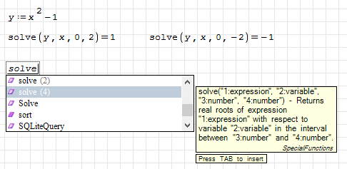

#4 Опубликовано: 16.10.2018 06:57:11
Use solve(4) instead of solve(2). The one with 2 arguments it's handly for calculations on the fly, but not reliable for structured calculations.
#5 Опубликовано: 16.10.2018 07:08:50
If you put some big range, you get wrong answers, like in this picture
You can't. Solve with default range for search "all" the roots it's just a helper for some easy calculations. If it give the correct answer, good, but if not, there are not to much to do.
For that you must to use the solve with 4 arguments (or other numerical solver), and get the roots one by one.
